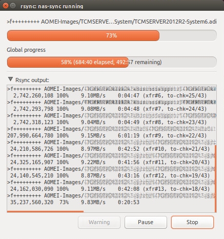

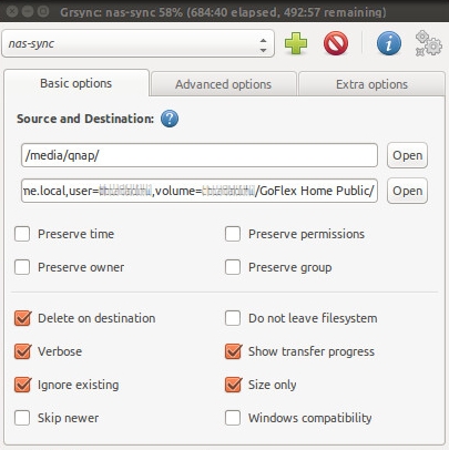

This is unrelated to the issue but I found a utility that works and has a GUI front end. It's just a front end for the rsync command but it has all the options I need, like ignore time and only compare by filesize. I've included screenshots to demonstrate what options I'm using.
It works somewhat slowly but that may be due to the fact that it's a VM with minimal resources and I've set it to compress data. At least the uploaded files don't get deleted though.
I like the interface for FFS better and would prefer to use it in the future if similar functionality was added.
