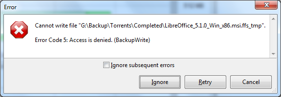

I'm still seeing this error with the files that I download with uTorrent. FreeFileSync successfully creates the .ffs_tmp file (I checked the file with a hash, and it was identical to the original), but then seems to run into problems when it wants to change the file name and set the last modified date.
The error is:
I tried running this backup with PureSync and it was able to do the backup successfully. So there isn't anything inherently wrong.
Could you please have a look at this.
The error is:
The access denied error seems to be caused by FreeFileSync not being able to access the ADS stream which marks a file as being downloaded from the internet: viewtopic.php?t=2316
The workaround would be to fall back on a stream-based copy that skips ADS (obviously what PureSync does).
The problem is likely a combination of ADS and the read-only flag: Probably the same issue as disccused here: viewtopic.php?t=4652
