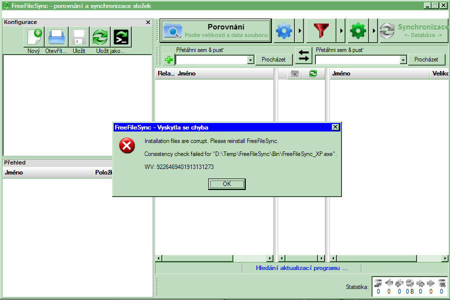

I have two machines with both 32 and 64bit versions of Windows XP.
When FreeFileSync v8.0 came out, I realized that every attempt to run it on these machines ends with "Consistency check failed" error.
The FreeFileSync installation itself is 100% defects free, because it's working perfectly on another system with Windows 7. It doesn't matter if I install it directly on Windows XP, or do it on Windows 7 and move the (portable) installation to the XP computers.
I do not dare to ask to hunt down this bug, because my XP installations are not standard and I don't know what components and functions the "Consistency check" depends on.
However I'd like to compile my own version of FreeFileSync, with "consistency" and "new version" checks removed.

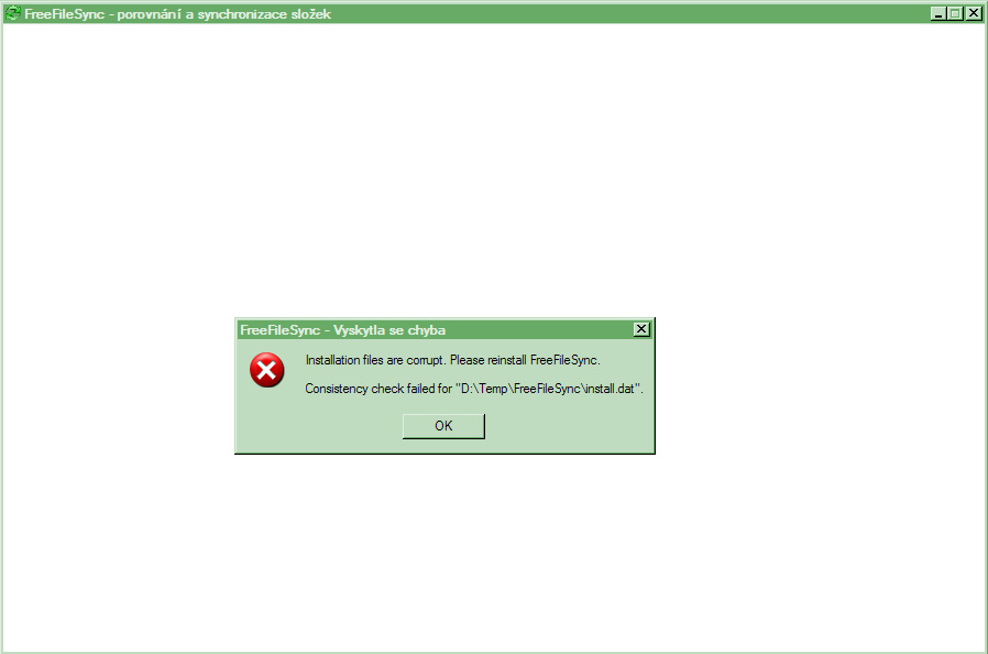

- Joined: 18 Mar 2016
Thanks, Zenyu, for the response.
I have tested that beta version and the result is the same. Only the check fails at different file - install.dat.
