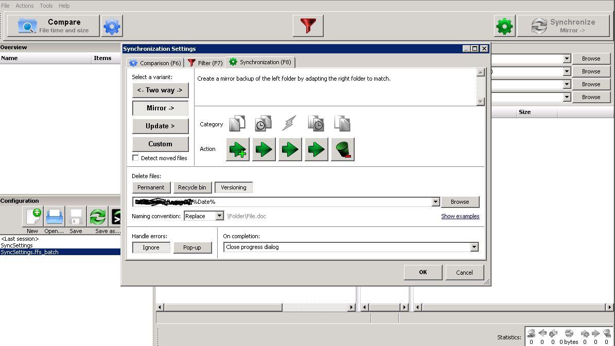

- Posts: 5
- Joined: 11 Dec 2014
There isn't any, check attached image.
- Posts: 73
- Joined: 13 Nov 2003
date is a macro, have a look under help / macros for more
e.g. weekday will give you a self maintaining grandparented set of 7, etc
if you want some completely arbitrary time based or number based setting you should roll it yourself.
you don't actually say what versioning limit you want
