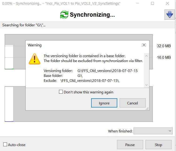

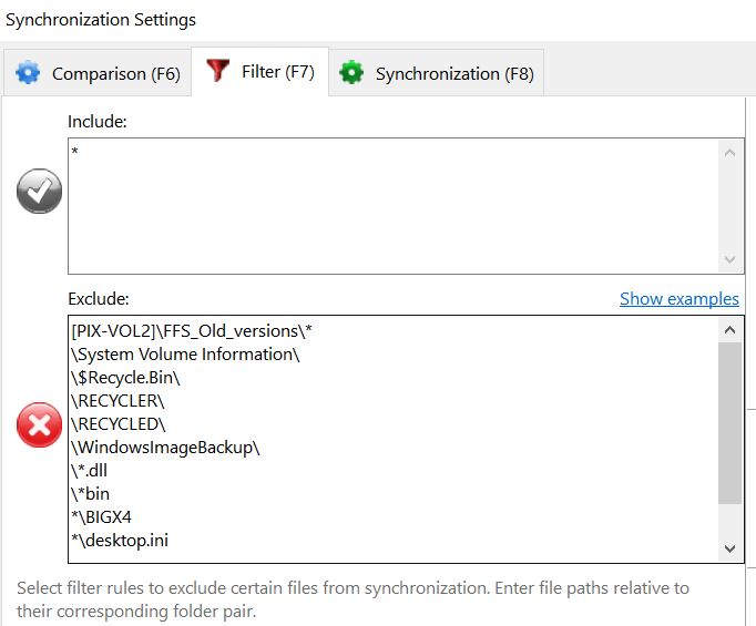

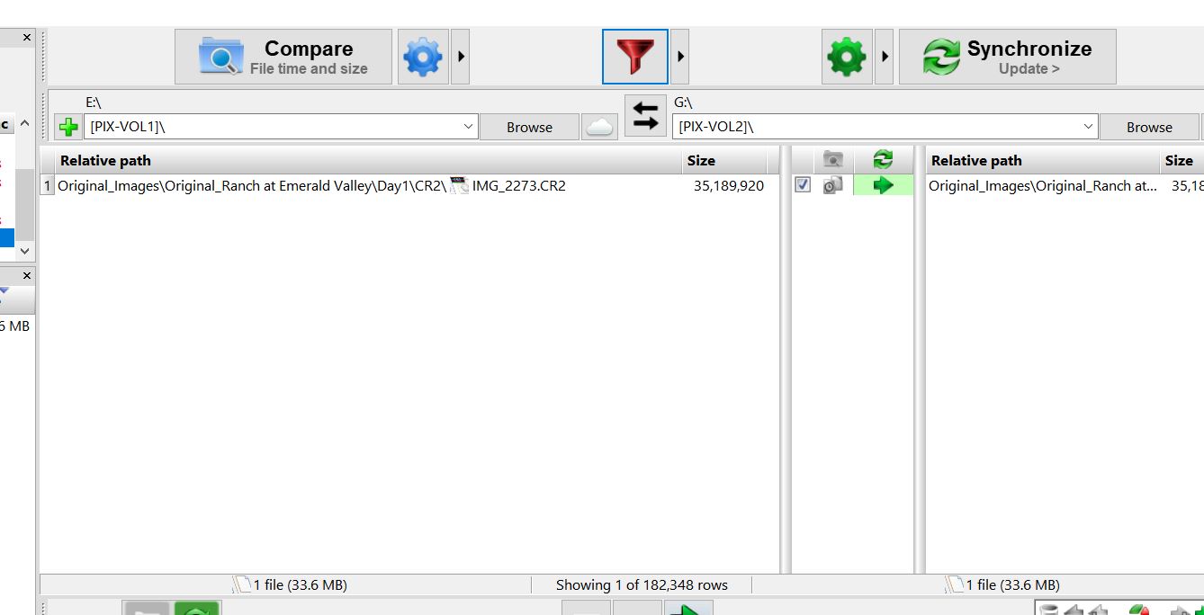

Now using version 10.2 under Windows 10 and it's still getting the error. Please see attached screen shot files. What should I try?
Thanks,
Steve

Posts: 7535
Your exclude filter is incorrect as you can see in the warning message.

What is the correct exclude filter?
Should I use: [PIX-VOL2]\FFS_Old_versions\%DATE%-%hour%
What do you suggest?
Many thanks,
Steve
Posts: 7535
The filter phrase shown in the warning message is the correct one.
