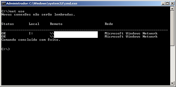

- Posts: 7567
This is not a general issue of RTS, but something specific to your "I: \" folder. The ReadDirectoryChangesW function seems to silently fail, most likely because it is not a SMB share.
- Joined: 14 Aug 2017
It's actually a sharing done in SMB.
