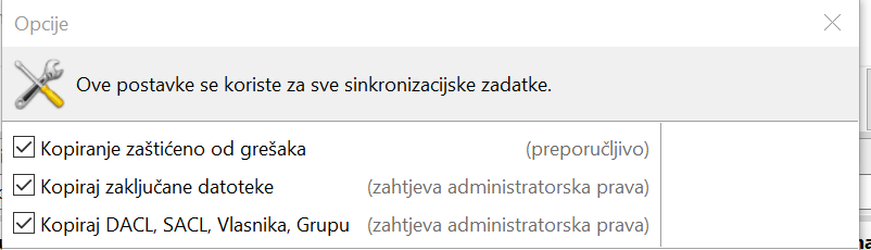

You must have the "Copy locked files" option enabled. I was having a similar problem and found that I had to use something other than "FreeFileSync.exe" in my scheduled task. Using "FreeFileSync.exe" seems to launch another executable in the bin folder. Only the initiating executable "FreeFileSync.exe" appears to have admin rights. I used "FreeFileSync_x64.exe" in the bin folder to solve my problem.
To run a scheduled task as administrator, you can use an account with admin privileges, or use the SYSTEM account.

- Joined: 17 Feb 2024
I solved my problem that way, thanksYou must have the "Copy locked files" option enabled. I was having a similar problem and found that I had to use something other than "FreeFileSync.exe" in my scheduled task. Using "FreeFileSync.exe" seems to launch another executable in the bin folder. Only the initiating executable "FreeFileSync.exe" appears to have admin rights. I used "FreeFileSync_x64.exe" in the bin folder to solve my problem.
To run a scheduled task as administrator, you can use an account with admin privileges, or use the SYSTEM account. fosterrf, 25 Aug 2018, 13:23
