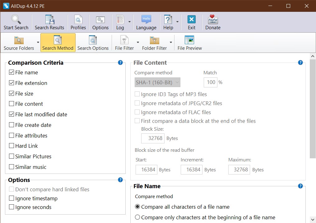

...however, I can't seem to make it work. AllDup lists thousands of files that are on both paths as allegedly "Non-duplicate files" in the log file.
This is even when they have the same name, date and size. These are my comparison settings:
Btw., what does "Ignore Timestamp" mean in the context of "Compare File last modified date"?
Does it check only the date and day but not the time of the day then?
- Posts: 333
- Joined: 13 Apr 2017
Ignore timestamp
This option enables you to ignore the timestamp when using the search criteria create date or last modified date.
It consider only the Date.
Ignore seconds
This option enables you to ignore the seconds from the timestamp when using the search criteria create date or last modified date.
It consider the Date, the hours and the minutes but not the seconds.
Ignore seconds

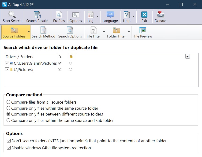

- in "Source Folders"
in the "Search which drive or folder for duplicate file" section, make sure to select only (add if needed) the LEFT and RIGHT folders and make sure is selected for both the option [x] "Search all subfolders"
in the "Compare method" section, select:
(*) "Compare only files between different source folders"

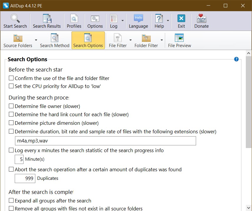

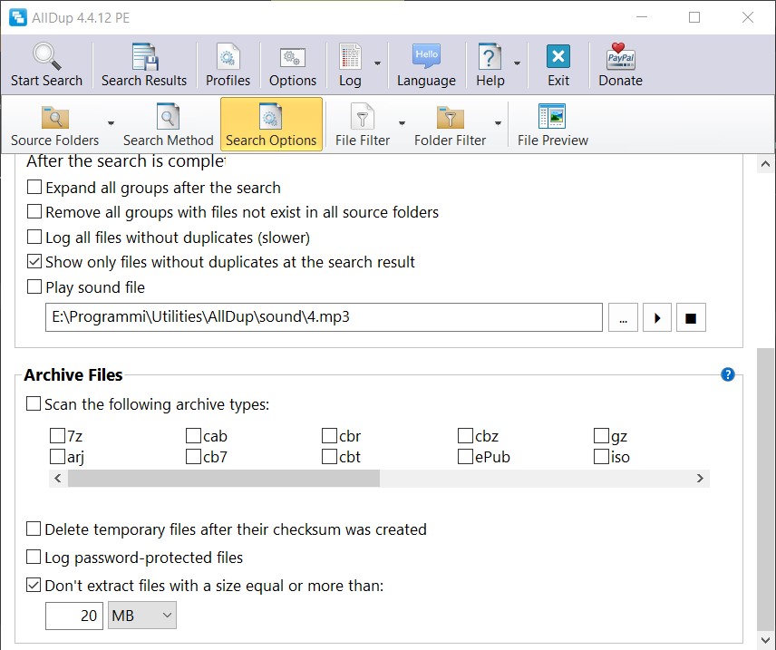

- in "Search Options"
in the "Search Options" section, select:
[x] Show only files without duplicates at the search result
"Start Search"

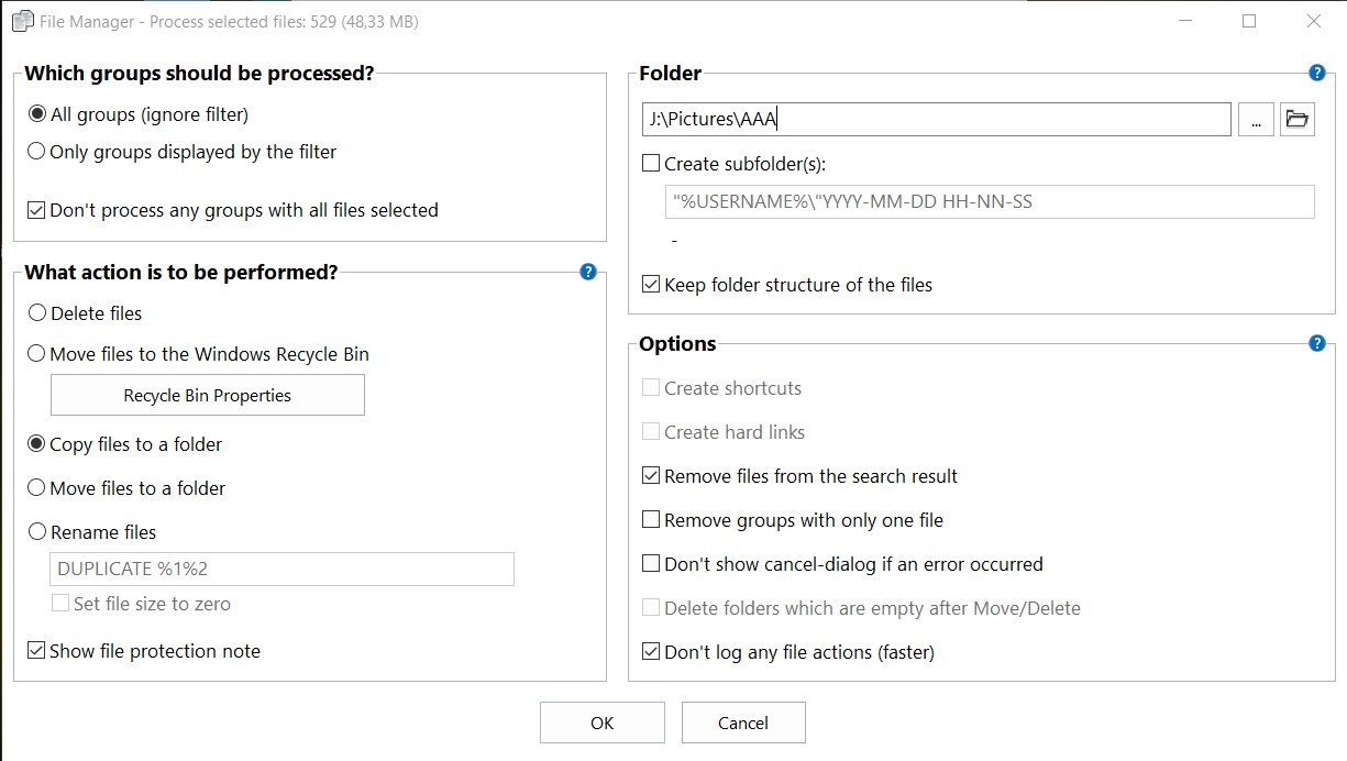

At the "File Manager" window ...
in the "Which groups should be processed?" section, select:
(*) All groups (ignore filter)
select [x] Don't process any groups with all files selected
in the "What actions is to be performed?" section, select:
(*) Copy files to a folder
in the "Folder" section:
select the destination folder, the RIGHT folder plus a subfolder to be created ad-hoc (J:\Pictures\AAA\)
deselect [ ] Create subfolder(s)
select [x] Keep folder structure of the files
Then press OK
"Start Search"

- open "Search Result", "File Manager - Delete, copy, move or rename selected files..."
Then press OK

- Posts: 333
Some screenshots in attachment.
