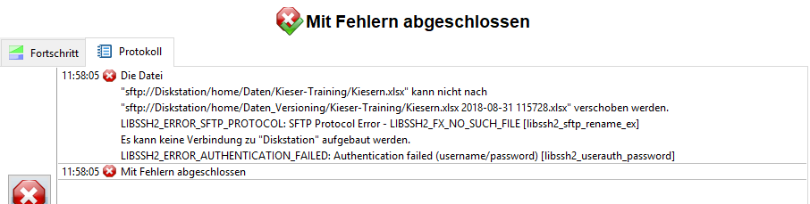

From time to time I get SFTP errors during syncing in a batch:
LIBSSH2_ERROR_SFTP_PROTOCOL: SFTP Protocol Error - LIBSSH2_FX_NO_SUCH_FILE [libssh2_sftp_rename_ex]

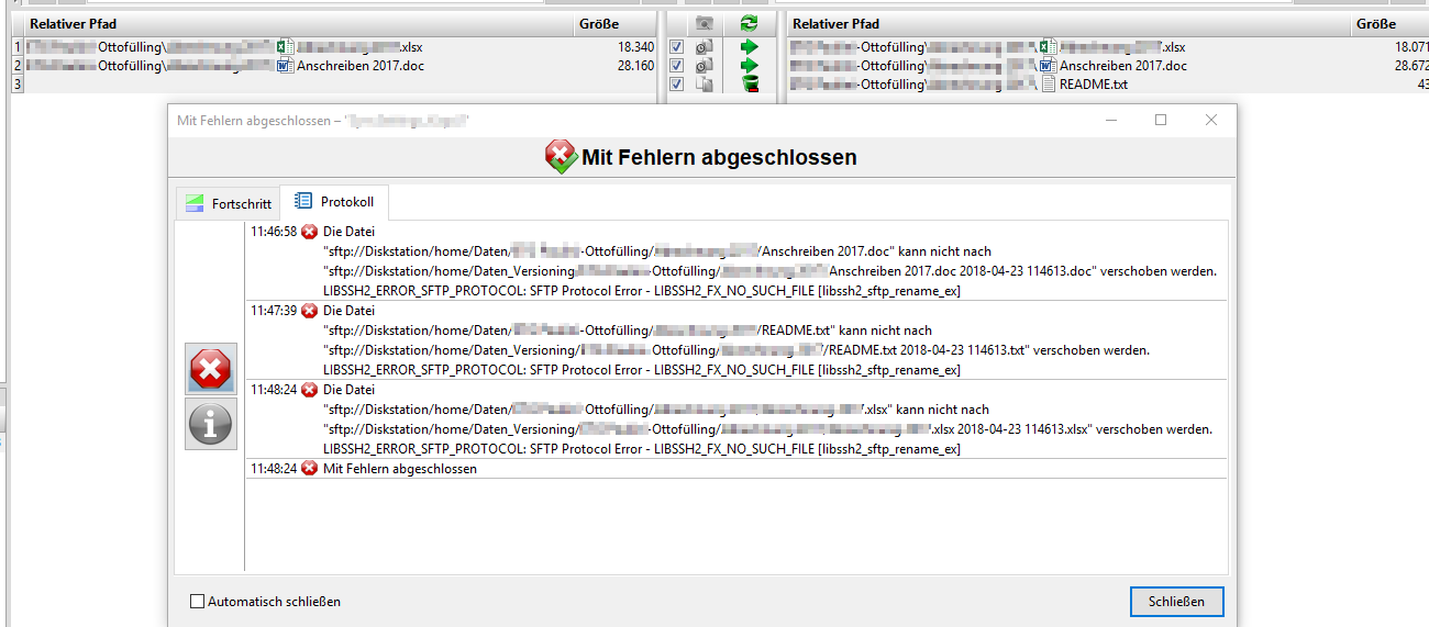

When using the desktop UI, the respective files are shown, but syncing fails (see attachment). I always have to solve these issues manually.
Is this problem related to FFS or the server (Synology Diskstation)? I can access the files (copy) with WinSCP without any problem. Perhaps it is due to the german umlaut in the path? But the umlaut is shown correctly in the UI...

Can you retry with the latest FFS version 10.0? It might give a more detailed error message. Are you able to reproduce this problem consistently? Can you manually check why the rename failed: It's possible that either the file at the source path or the target folder were missing.

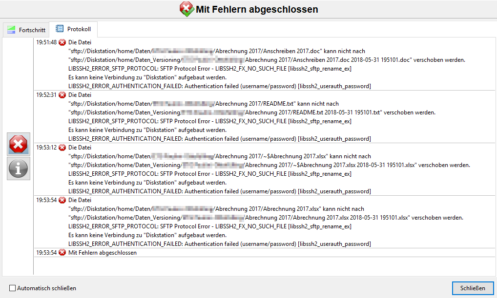

Yes, I can reproduce the problem with these files consistently. And it still happens with version 10.0. According to the detailed error message, authentication fails (see screenshot). All other files are synced with no problem at all, even files with Umlauts in its path or filename. Why does authentication fail for certain files...?
BTW: Does FFS login for every file? I recently found out, that the ip address of my PC was blocked on the NAS due to too many logins since a couple of days. (default for Synology Diskstation is more than 10 in 5 minutes) I needed to whitelist the ip address. The errors in the screenshot below happened after whitelisting!

Zenju, I also checked your last hint now. The target directory was missing. (That's OK, because there was nothing for versioning before.) After creating it manually on the NAS, the sync succeeded now!
I'm pretty sure FFS sees it as its task to create the directory during sync. So why is the directory still missing when FFS tries to move the old file?

Yes. I assume the original connection was considered broken after failing to move to the target folder, even though a missing target folder is a recoverable error. This can happen if the connection didn't produce a successful call for at least 20 seconds. (Maybe you have retry enabled with a long delay???)I'm pretty sure FFS sees it as its task to create the directory during sync. KarstenP, 02 Jun 2018, 09:33
A second connection is attempted to create the missing target folder, but then fails due to connnection limits on your server because the old connection is not immediately closed: LIBSSH2_ERROR_AUTHENTICATION_FAILED

Now the problem is back for another file and I upgraded FFS from version 10.0 to 10.3 to test your fix. Unfortunately the problem is NOT solved. I still can't sync this certain file (others work flawlessly), error message is the same as before:
Again, it is the first time this file is versioned, so the directory does not exist yet. I did not solve the problem manually, so I can reproduce the error any time, in case you want me to test something.
