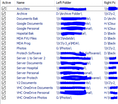

Being new to this prgramme after using SyncToy I would like to have answers to the following:
1. Can a number of sync pairs be created and then made to run as one batch?
2. Can a number of sync pairs be made to run by RealTimeSync? If yes, then can you guide to a tutorial.
Thanks in anticipation and regards,

By trial and error have succeeded in creating a batch file for multiple sync pairs and successfully running it.
As for RealTimeSync found that it can run only one batch file and hence incorporated multiple sync pairs in one batch file which is made to run with RealTimeSync.
