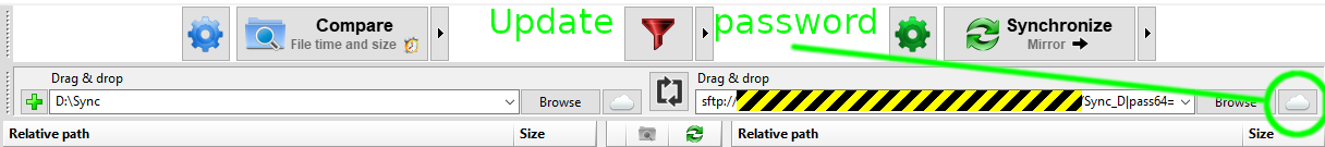

Click the "cloud" icon to the right of the dialog with your path. Shown below.

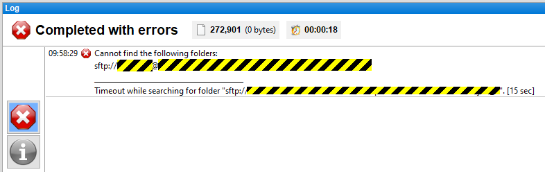

Also worth noting is that you won't get any notification by default if the SFTP task is the only one in a job and it fails. If you check the log you will see the error, as shown below, but the task fails silently, with no error icon if you just run it alone, which could lead you to falsely believe that there were no changes to sync!
