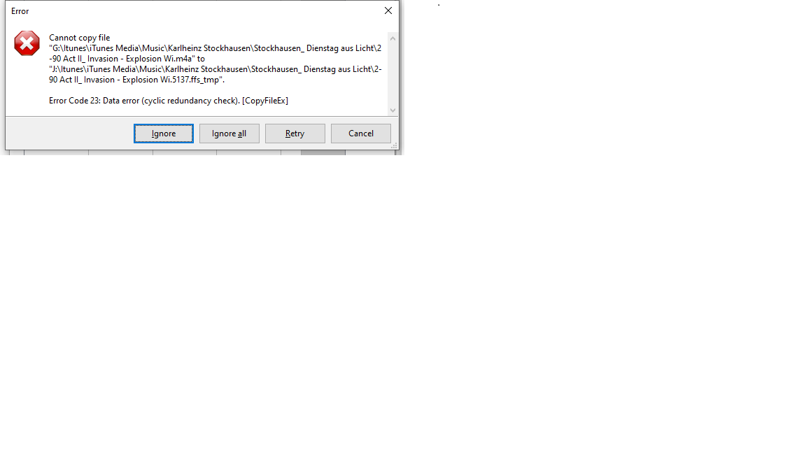

howard.stokar
All tests show no problem with drives. See attached png
Posts: 4946
Just try copying that file manually
