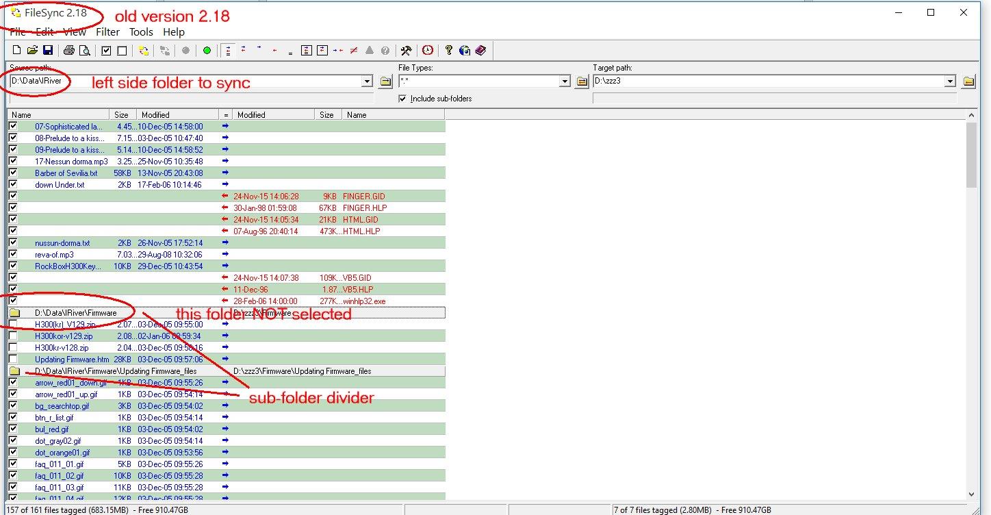

I'm not sure what "folder separator" you're refering to. Maybe you can post a screenshot?
- Joined: 24 Nov 2015
This is from ver 2.18
ignore what's on the right side (targetn), it is just to show what I mean by "folder separator"
left side (source) is d:\data\iriver.
I clicked the line for sub-folder d:\data\iriver\firmware
and all the files in it are not selected when compare to right side
so when comaprison AND syncing is done, those file will not be copied to targert (right side)
I think I got it.This is from ver 2.18
so when comaprison AND syncing is done, those file will not be copied to targert (right side)boten
The folder selection is in the middle with check-marks
once I un-check the box right of a folder name, it disappears from the list (insted of being un-checked).
I wish it would stay on the list (with all it's sub-folders and files) and with un-checked box, so I cud see what is it that I un-checked (maybe by mistae) and can check it again.
Maybe there's an option to it i'm not aware of
