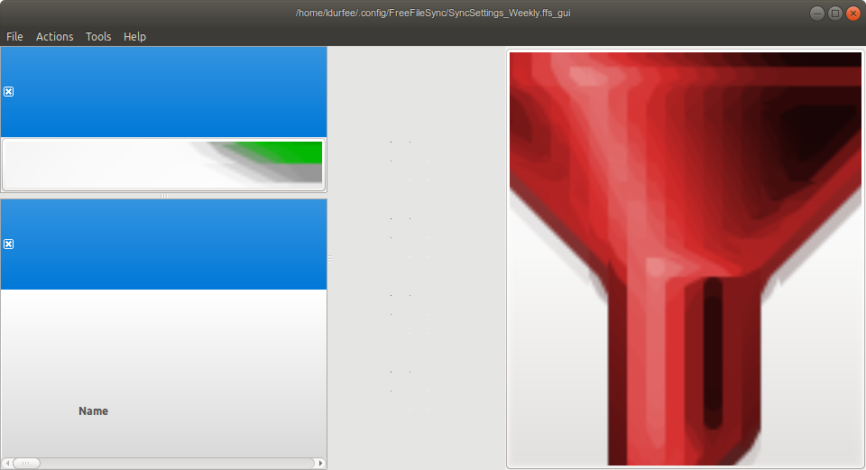

I have been using FreeFileSync for a few weeks and it's great. However, all of the sudden the icons got so big, only one fits on the screen. It makes the program useless.
I then installed (manually) v 10.9 and the same problem exists. When I run it from a command line, I get the following error messages.
FreeFileSync_x86_64:6928): Gtk-CRITICAL **: 08:35:38.634: IA__gtk_widget_set_size_request: assertion 'width >= -1' failed
(FreeFileSync_x86_64:6928): Gdk-WARNING **: 08:35:39.093: gdk_window_set_icon_list: icons too large
Can anyone help?
FreeFileSync_Screenshot from 2019-02-20.png (84.56 KiB) Viewed 2098 times
Just to give an idea of the problem, see screen shot above. Can not use the program as is.

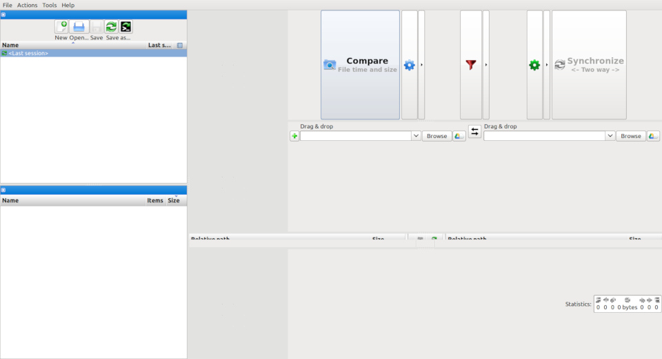

The GTK2 one looked different, and when I reset the layout it looked a little better. It was still all out of whack though, with vertically stretched and compressed elements, and a big space I couldn't fill. I could make it usable by dragging resize-handles, but I couldn't make it look normal. I can send a screenshot if it will help. The GTK3 one, after resetting the layout from the previous test, looks normal. Does that reveal anything?

I can send a screenshot if it will help. jhbau3, 05 Sep 2019, 16:12
Definitively! A screenshot after "menu->tools: reset layout" will help. Unfortunately this issue cannot simply be solved by using GTK3 (which has other unrelated problems that need to be addressed first, before FFS+GTK3 is ready for production).

Okay, this is with GTK2, right after "Reset Layout" (scaled down from 1920 wide). I can, from the point shown, drag grab handles on several of the elements to improve it somewhat, but this is what you asked for.
FFS GTK2 after reset layout.jpg (64.59 KiB) Viewed 1786 times

As I suspected, the wxWidgets code inside wxAui is also broken. Let's make one more test: I've hacked wxWidgets to disable high DPI support even for GTK2. How does the following version look? (after layout reset)
https://www.mediafire.com/file/zwy4szqmcmjbvuf/FreeFileSync_10.16_beta_Linux_GTK2_No_High_DPI.tar.gz
Posts: 6
Joined: 3 Sep 2019
jhbau3
Thanks again. That looks perfect!
