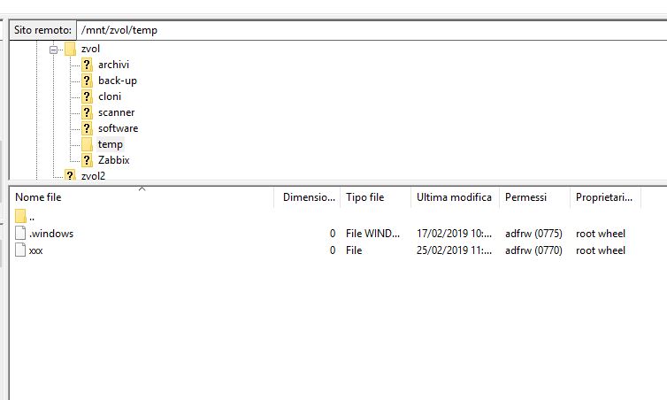

If I try to correctly access to Freenas via Filezilla it works perfectly. Attachment FFS2

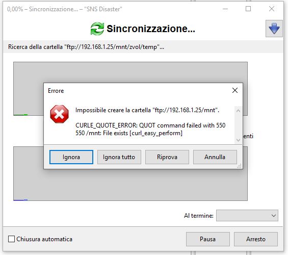

Tried to input the absolute path in Freeflie Sync but it answers me as attached FFS1

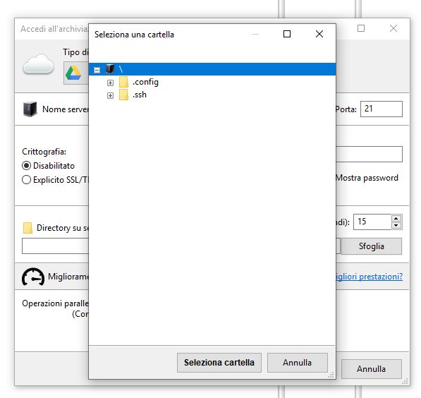

If I try to browse for the folder in the Freenas through FFS it answres me as in the attachment FFS3

Not sure though what you did in FFS1.jpg so that FFS tries to create the "/mnt" folder although it already exists.

No matter the path I insert it doesn't work. FFS just see home folder as in FFS3.jpg
In FFS1.jpg I'm just trying to mirror the nas folder /mnt/zvol/temp to a local folder
I was able to reproduce the problem on my side with FreeNAS. libcurl defaults to user-home-relative paths during folder traveral while FreeNAS also supports root-relative paths, so there is a little communication problem regarding what a path represents. Fixed by forcing curl to always use root-relative paths.
