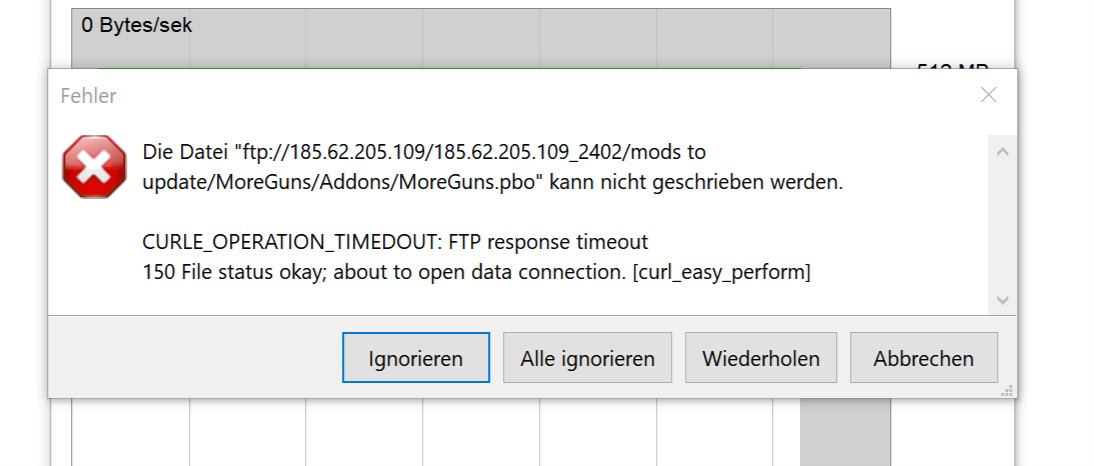

There you go. The first thing in the video you see is my file i want to upload. It has a file size of 550~ MB.
The Target folder is empty.
This test is with the current 15 timeout setting. You see the abort, also i Abort the hole thing, and close the Program. After that i open File zilla , navigate to the folder and simple press F5 for refresh. You see the file size is growing. My Max Upload is 1.2 MB per second. Taskmanager shows more because its a 10mbit conection.
Funny thing, on background the file will uploaded until its reachid his 550MB.... Dont ask me why this happens. I have no idea...

Got the same error: CURLE_OPERATION_TIMEDOUT: FTP response timeout
May its a Server Side Problem?

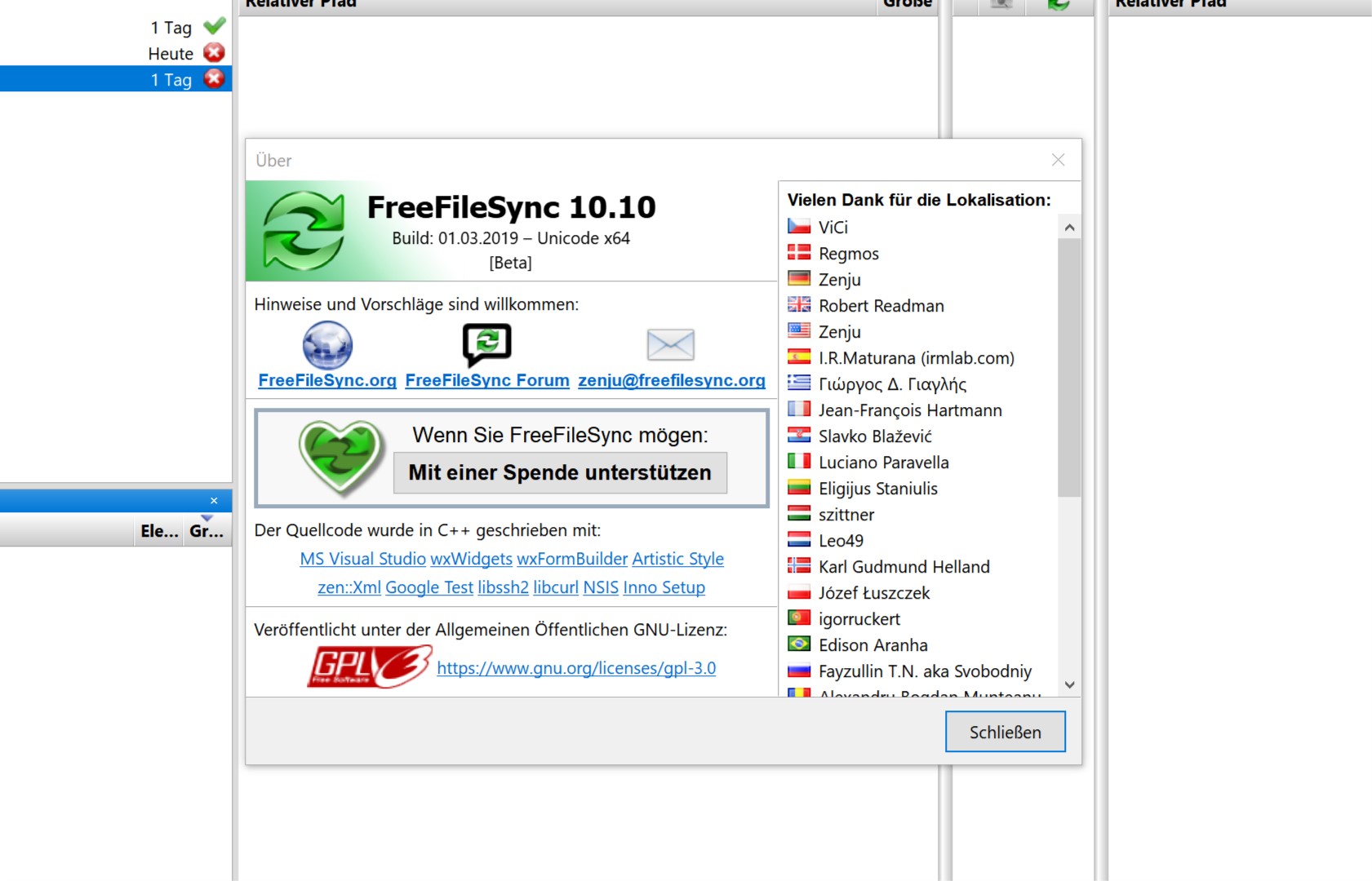

to 1. Last Test was with the 10.10. (Screenshot) ( The edit on my last post)
On the video i was using the older version. Just want to show the upload thing.
2. Done
3. Hmm thats the point. I have a "kiler Network Manager" installed, that comes with the Laptop. May this is the reason. I dont install any other tunings tuff. But may this causing the Problem...
Need to find then drivers only. If not i fhave then to use filezilla for bigger files. On the Screens you can see, still the same problem. Also with the beta.
