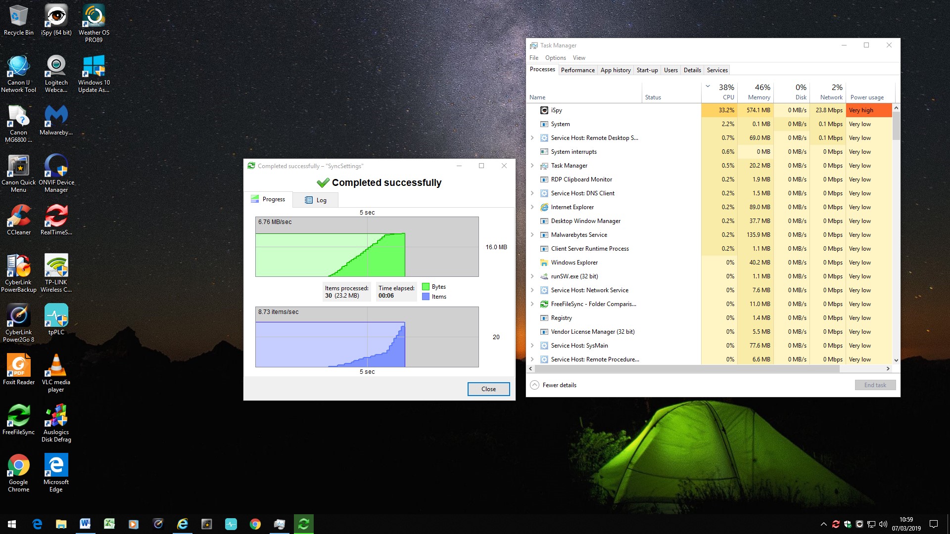

I have created a FFS batch file to copy video files from a Windows 10 CCTV app to a backup network drive. This runs perfectly.
I then built a RealTimeSync task using the FFS batch file and this also runs perfectly until it completes the first sync with a "Completed Successfully" status screen.
I have attached a screen shot to illustrate this stage.
At that point, everything stops and RTS will not launch another sync until you press the "Close" button on the status screen. Then RTS runs one more time to the same "Completed Successfully" status.
During the "Synchronising" status, there is an "Auto-Close" tick box and if you click on that, the status screen does close by itself and RTS launches just once more to the same "Completed Successfully" status.
I have searched for a way to set "Auto-Close" permanently, but cannot find this and would appreciate your help.
If this can be made to work, then FFS and RTS will be the ideal solution for me.
Many thanks

Did you mark the Auto Close option when creating the batch job?
See the Manual section on Schedule Batch Jobs, bullet 2.
- Joined: 7 Mar 2019
Ahhhh!! So simple, when you know how - and I obviously looked in the wrong place.
Many thanks, much appreciated, all is now working well.
