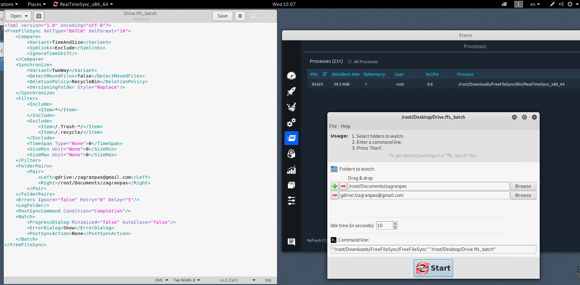

I do the following:
1. Syncing in FreeFileSync google drive with folder on disk has no problem (except 0-size of google docs)
2. I made batch job, based on this sync. (File "Drive.ffs_batch") see picture
3. I open RealTimeSync, and open file "Drive.ffs_batch". All fields are filled. see picture
4. I press "Start" button on RealTimeSync. It closes.
5. I see running RealTimeSync in task manager. see picture.
But there is no syncing at all.
Why???

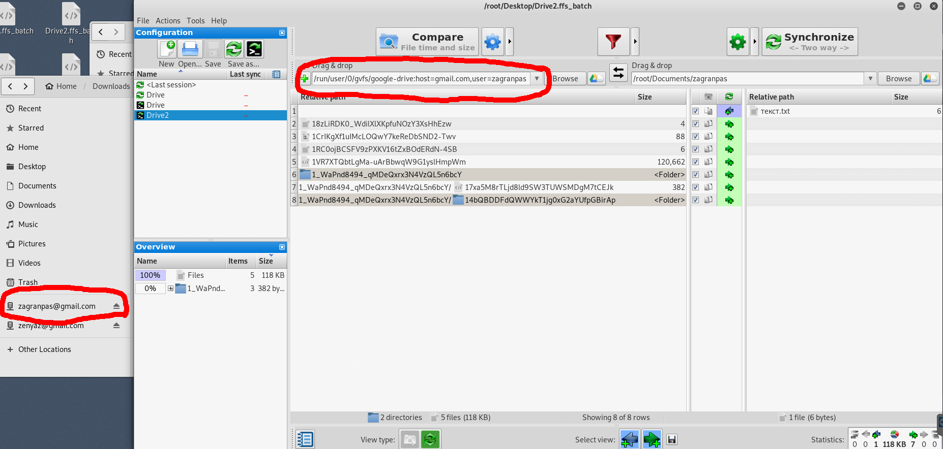

When i try point Gdrive not directly, but via attached folder in explorer - all filenames became corrupted. See the other picture.
The question is:
How synchronize Gdrive with RealTimeSync?

Posts: 7535
2. I made batch job, based on this sync. (File "Drive.ffs_batch") see picture ice99, 20 Mar 2019, 07:34
Strange, this should have failed with an error message instead:
viewtopic.php?t=6004#p19724
However: Supporting Google Drive in RealTimeSync *is* possible (e.g. via polling every 10 seconds), unlike FTP, or MTP. So maybe I'll add that at some time.
When i try point Gdrive not directly, but via attached folder in explorer - all filenames became corrupted. See the other picture. ice99, 20 Mar 2019, 07:34
I think this is a bug in GVFS, not FreeFileSync. In any case, you can open Google Drive in your web browser and have a look. The files are probably okay.
Joined: 20 Mar 2019
ice99
However: Supporting Google Drive in RealTimeSync *is* possible (e.g. via polling every 10 seconds), unlike FTP, or MTP. So maybe I'll add that at some time. Zenju, 20 Mar 2019, 09:52
As far, as i understand RealTimeSync with Gdrive is NOT possible NOW? Right?
Posts: 7535
Exactly, I'm just wondering why you didn't get an error message when starting RTS that would have explained just that.
