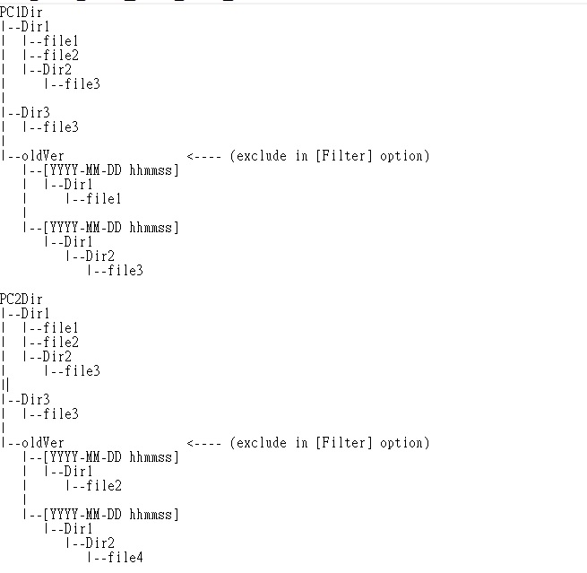

My case is using FFS to synchronise data between 2 PCs. I want to keep the deleted files in the PCs respective.
PC1Dir
|--Dir1
| |--file1
| |--file2
| |--Dir2
| |--file3
|--Dir3
| |--file3
|--oldVer <---- (exclude in [Filter] option)
|--[YYYY-MM-DD hhmmss]
| |--Dir1
| |--file1
|--Dir1
|--Dir2
|--file3
PC2Dir
|--Dir1
| |--file1
| |--file2
| |--Dir2
| |--file3
|--Dir3
| |--file3
| |--Dir1
| |--file2
|--Dir1
|--Dir2
|--file4
However, the option inside [Delete files -- Versioning] is keep all deleted files to one side only.
Any [Macros] can be use in the option [Delete files -- Versioning -- Move files to a user-defined folder] for this case?
If not, will FFS add this [Macros]?
eg. [RespetiveFolder] represent the LeftSideFolder or RightSideFolder due to the items delete/move in the respective side.
I am looking for your help. Thank you very much!

In this case, data may be modify at both PCs. Two-way sync mode will be use. To prevent the unwanted change, the old version will be keep in respective side with period, and need to know it come from which PC.
The single location for deleted/modified files will increase the network traffic in this case. And, don't know the old files from which PC.
I hope FreefileSync will add the option to hold the deleted/modified files separately.
