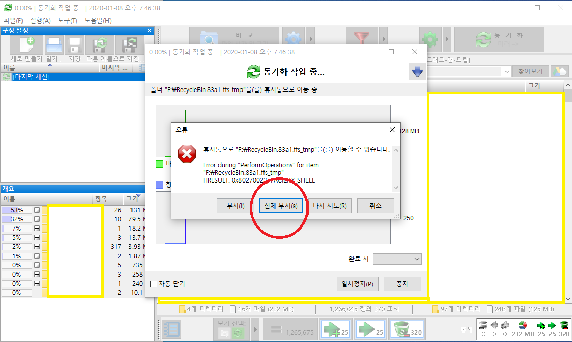

I want to set mirroring starts, and mirroring until the end without person need to click any of the button to complete the mirroring .
Everytime I try to mirror, it has some files that is not able to move.
Is there anyways to set automactical setting to ignore all problem befrome moving files?
Thank you!
Posts: 3021
Did you try storing your sync as a *.ffs_batch-file, and select to Ignore Errors when saving.
See here (the second box marked in red).
