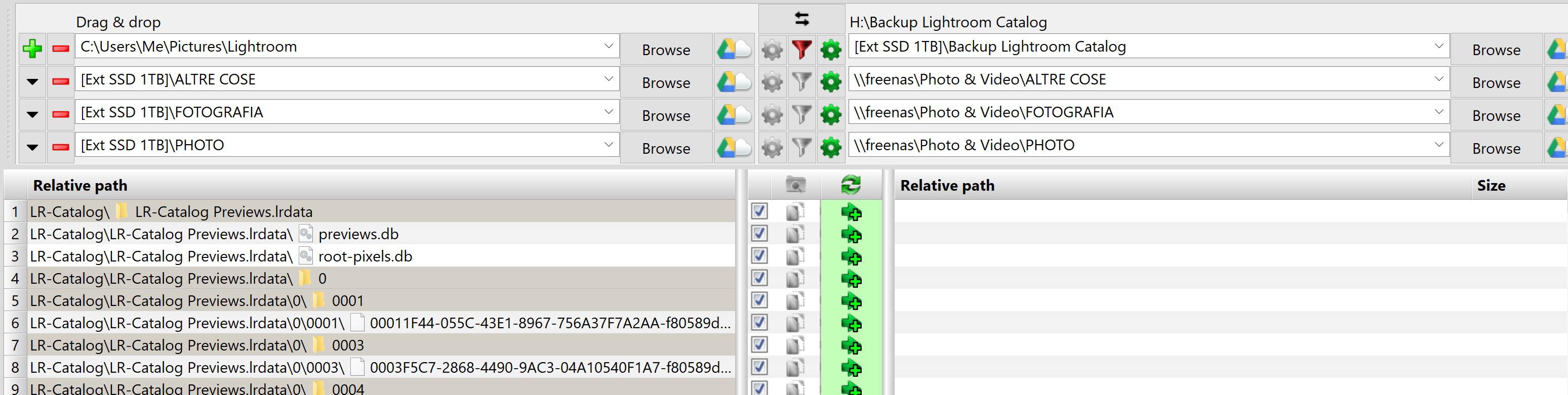

A quick update...
I have tried my old trusty 10.7 Donation Edition and it displays the same "problem".
As soon as a synchronization finishes, if I press Compare, it shows the same list of files to be synchronized.
I suppose there is something related to a Windows update instead of a change/bug in the later versions of FreeFileSync.
I keep investigating...

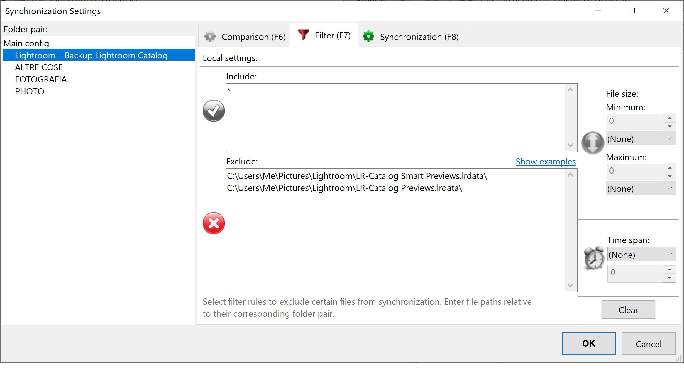

Further investigation...
Even if I have excluded a few folders,
they are still evaluated in the comparison. Am I doing something wrong?

I have solved the problem on post 5, my fault.
The excluded path was
C:\Users\Me\Pictures\Lightroom\LR-Catalog\LR-Catalog Previews.lrdata
instead of
\LR-Catalog\LR-Catalog Previews.lrdata\
The main problem of presenting the same file to sync, just after a sync is complete, remains.

You should be able to find out why FFS is copying files by looking at the columns in the middle.
And there's also https://freefilesync.org/faq.php#different-after-sync
