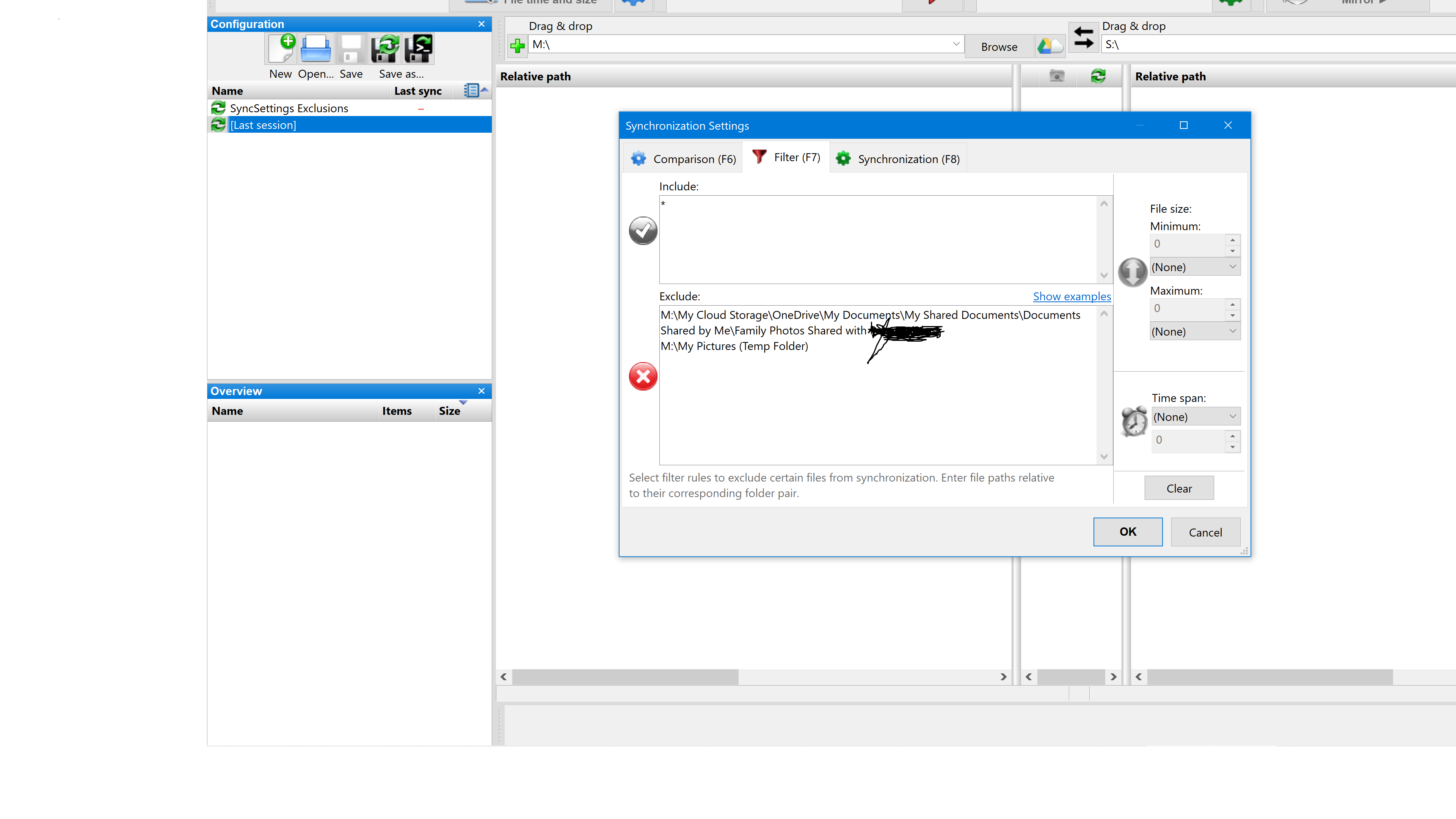

Can you screenshot your filter settings?

Attached. M:\ is the Source Drive, S:/ is the destination.
Add this to the exclusions:
\System Volume Information\

This looked promising - when I added those lines, it started working perfectly combing the drives for changes.
However, it errored out because of insufficient space on the destination drive. When I inspected the details of what it was backing up it had not excluded the files from the first exclusion.
This problem of ignoring the first exclusion happens regardless of whether I put the lines that you added to either the beginning, or the end of lists of exclusions.
Is there something wrong with the Path? The part I blacked out includes two names and an "&". Are special characters allowed in the path? Or is it too long?
Take out the drive letters and leave it as "\My Cloud Storage\OneDrive\xxxxxxx\Documents\"
Same with the temp picture folder
For the shared folder, I haven't used that and I'm not sure it is supported. If you can format it as the other two lines, it may work as well

Implicit in xCSxXenon's reaction, but for Norman's clarity:
Your initial Exclude Filter specification contained full-path specifications.
However, as clearly stated at the bottom of the Filter Settings window:
"Enter file path relative to their corresponding folder pair"
This means: relative the left and right base folder pair.
