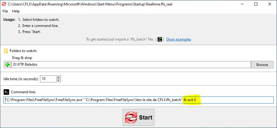

I encountered the same issue, Could you tell me where and how to add " & exit 0" to fix this problem.
Posts: 4941
If you open the RTS configuration box, there is a text box that contains your command string from the picture. It you add " & exit 0" to the end, the error stops. That is a space, the '&' character, another space, 'exit', one last space, and a '0'. RTS will check for exit code 0 because that means a successful sync, but it is now returning different error codes

Adding that to the end doesn't affect anything. All it does is run a second command "exit 0" which sets the %errorlevel% to 0, which RTS then reads and then considers successful. If there are errors after adding that, it was either configured incorrectly or the errors would have be present without the exit call
