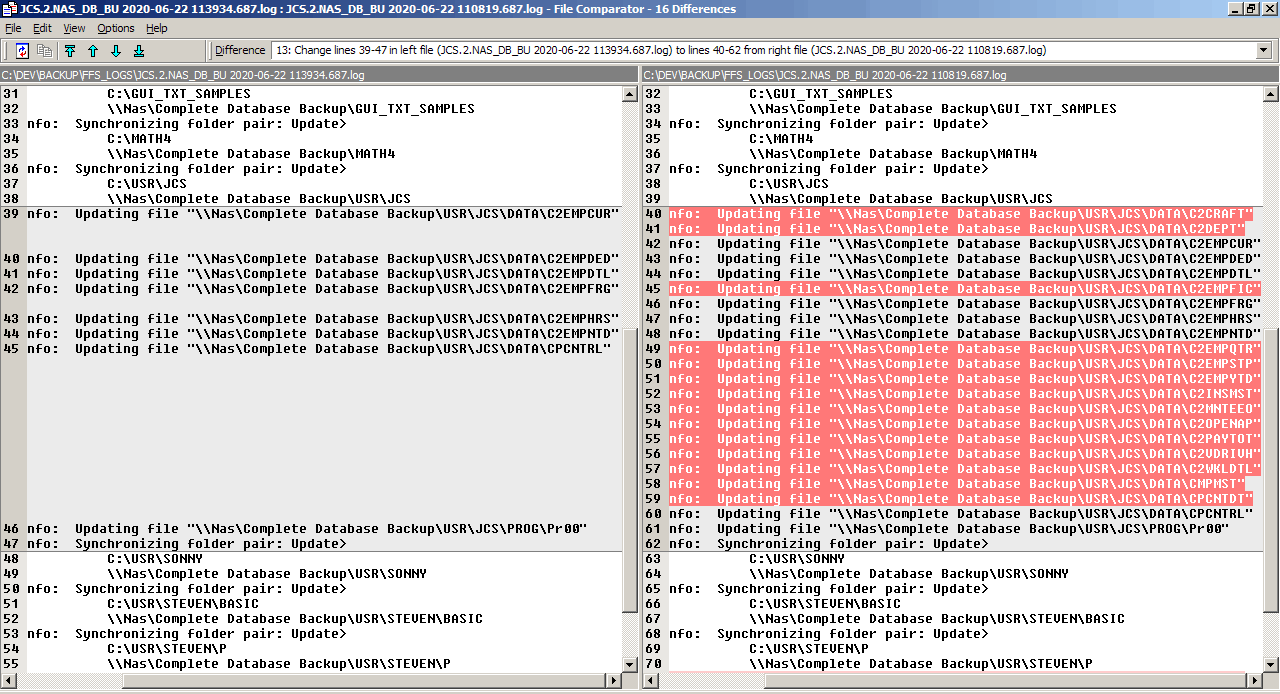

So today, I updated some files:
__________________________________
|06/22/2020  JCS.2.NAS_DB_BU
|    Completed successfully
|    Items processed: 25 (2.18 MB)
|    Total time: 00:00:03
[11:08:21 AM]  Info:  Updating file "\\Nas\Complete Database Backup\USR\JCS\DATA\C2CRAFT"
[11:08:21 AM]  Info:  Updating file "\\Nas\Complete Database Backup\USR\JCS\DATA\C2DEPT"
[11:08:21 AM]  Info:  Updating file "\\Nas\Complete Database Backup\USR\JCS\DATA\C2EMPCUR"
[11:08:21 AM]  Info:  Updating file "\\Nas\Complete Database Backup\USR\JCS\DATA\C2EMPDED"
[11:08:21 AM]  Info:  Updating file "\\Nas\Complete Database Backup\USR\JCS\DATA\C2EMPDTL"
[11:08:21 AM]  Info:  Updating file "\\Nas\Complete Database Backup\USR\JCS\DATA\C2EMPFIC"
[11:08:21 AM]  Info:  Updating file "\\Nas\Complete Database Backup\USR\JCS\DATA\C2EMPFRG"
[11:08:21 AM]  Info:  Updating file "\\Nas\Complete Database Backup\USR\JCS\DATA\C2EMPHRS"
[11:08:21 AM]  Info:  Updating file "\\Nas\Complete Database Backup\USR\JCS\DATA\C2EMPNTD"
[11:08:21 AM]  Info:  Updating file "\\Nas\Complete Database Backup\USR\JCS\DATA\C2EMPQTR"
[11:08:21 AM]  Info:  Updating file "\\Nas\Complete Database Backup\USR\JCS\DATA\C2EMPSTP"
[11:08:21 AM]  Info:  Updating file "\\Nas\Complete Database Backup\USR\JCS\DATA\C2EMPYTD"
[11:08:21 AM]  Info:  Updating file "\\Nas\Complete Database Backup\USR\JCS\DATA\C2INSMST"
[11:08:21 AM]  Info:  Updating file "\\Nas\Complete Database Backup\USR\JCS\DATA\C2MNTEEO"
[11:08:21 AM]  Info:  Updating file "\\Nas\Complete Database Backup\USR\JCS\DATA\C2OPENAP"
[11:08:21 AM]  Info:  Updating file "\\Nas\Complete Database Backup\USR\JCS\DATA\C2PAYTOT"
[11:08:21 AM]  Info:  Updating file "\\Nas\Complete Database Backup\USR\JCS\DATA\C2VDRIVH"
[11:08:22 AM]  Info:  Updating file "\\Nas\Complete Database Backup\USR\JCS\DATA\C2WKLDTL"
[11:08:22 AM]  Info:  Updating file "\\Nas\Complete Database Backup\USR\JCS\DATA\CMPMST"
[11:08:22 AM]  Info:  Updating file "\\Nas\Complete Database Backup\USR\JCS\DATA\CPCNTDT"
[11:08:22 AM]  Info:  Updating file "\\Nas\Complete Database Backup\USR\JCS\DATA\CPCNTRL"
[11:08:22 AM]  Info:  Updating file "\\Nas\Complete Database Backup\USR\JCS\PROG\Pr00"

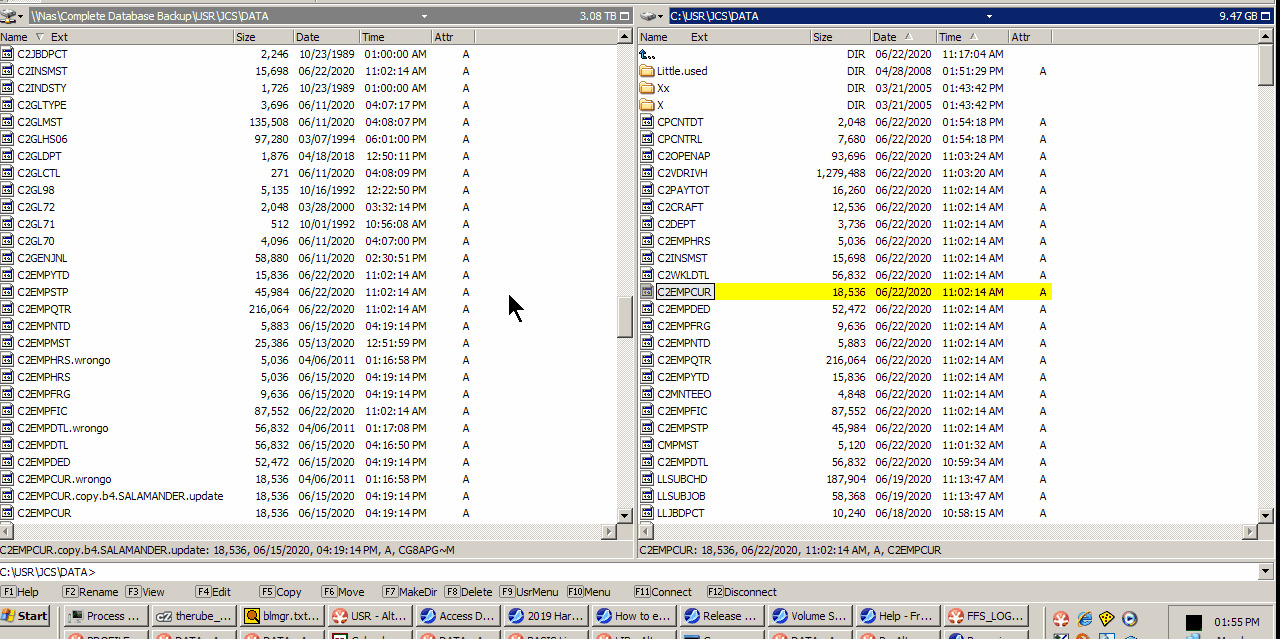

What happens - when I look at the source & backup files, comparing size/date, some (not all) of the files that backed up have OLD date/time. (Lack of a size change may not necessarily be an indicator of an actual file change.)
When I look further, the source & backup files are identical - so only the timestamp is different - & again, for only some of the files.
And what happens after that, is that these "old" files repeatedly "update" (but again their timestamps do not update) so are not recognized as having updated (when comparing based on size/date).
[11:39:35 AM]  Info:  Updating file "\\Nas\Complete Database Backup\USR\JCS\DATA\C2EMPCUR"
[11:39:35 AM]  Info:  Updating file "\\Nas\Complete Database Backup\USR\JCS\DATA\C2EMPDED"
[11:39:35 AM]  Info:  Updating file "\\Nas\Complete Database Backup\USR\JCS\DATA\C2EMPDTL"
[11:39:36 AM]  Info:  Updating file "\\Nas\Complete Database Backup\USR\JCS\DATA\C2EMPFRG"
[11:39:36 AM]  Info:  Updating file "\\Nas\Complete Database Backup\USR\JCS\DATA\C2EMPHRS"
[11:39:36 AM]  Info:  Updating file "\\Nas\Complete Database Backup\USR\JCS\DATA\C2EMPNTD"
[11:39:36 AM]  Info:  Updating file "\\Nas\Complete Database Backup\USR\JCS\DATA\CPCNTRL"
And the next log shows the same... & the next... & the next...

I'm backing up from an XP machine (source files) to a Synology NAS (using whatever their default "proprietary" OS is).
