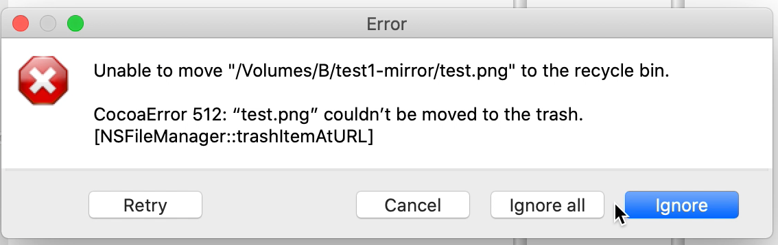

When my mirror files needs to be deleted,the FreeFileSync shows Unable to put file in recycle bin.
COCOA ERROR 512.
SO ,I have to delete it manually to back up the files properly
This is not the case with the main hard disk, but with other hard disks
It's very inconvenient. I don't know what to do

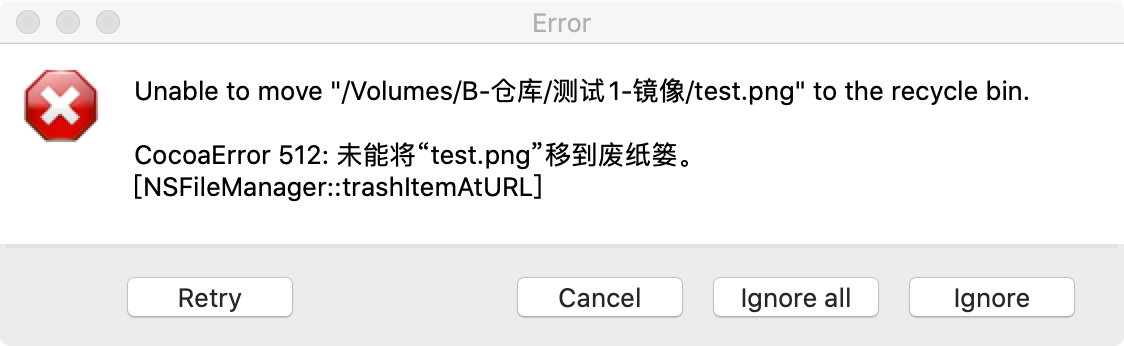

SORRY ,My version is in Chinese,I don't know if my expression is accurate.
In short, this software does not have permission in some hard disks. How should I set it
Posts: 7535
What is the full error message?

Posts: 7535
Can you copy and paste the text? Or better: set the language to English?

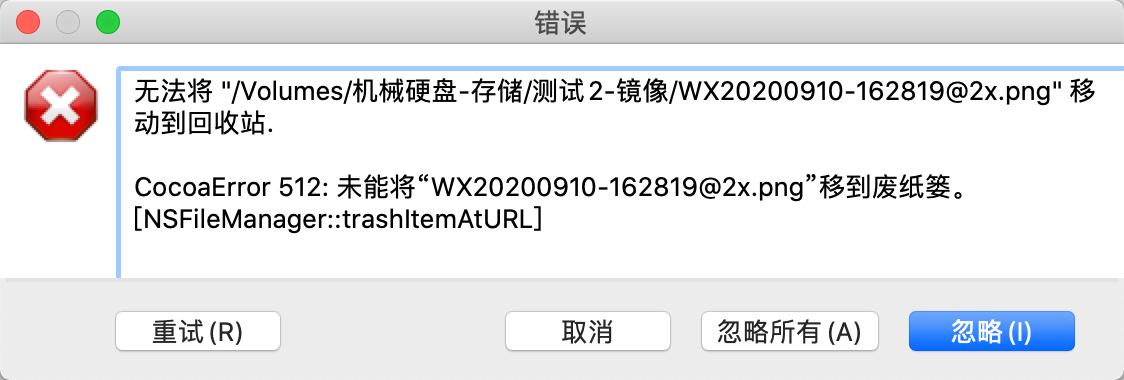

May be that the software does not have administrator rights to delete files on this disk?
There are several hard disks in my computer, some of them are OK, some are not

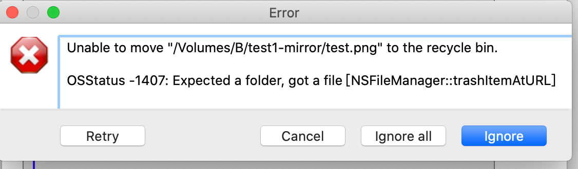

It's a bit of a wild shot, but maybe theres an underlying error available to report instead. Do you get a different error message with the following version?
https://www.mediafire.com/file/xlzglaefom3b0r9/FreeFileSync_11.2_beta_macOS(2).zip
Posts: 12
Joined: 10 Sep 2020
99184806
FreeFileSync_11.2_macOS
It still failed
But the error message is different

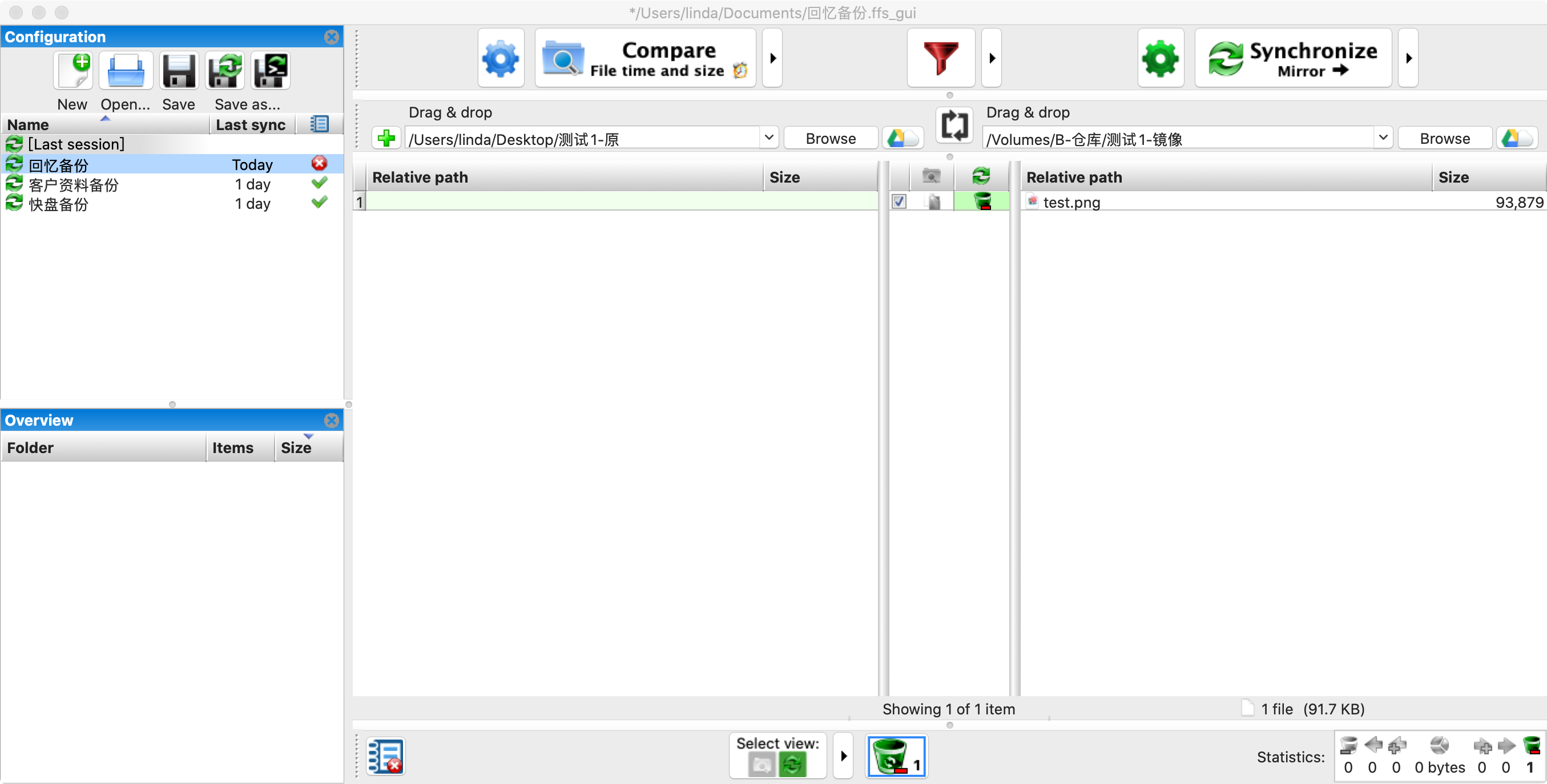

Sorry,I made a mistake before.
Successful and failed on the same physical hard disk
Different partitions
Successful partition in exFAT
Failed on NTFS partition
Maybe that's the problem?
