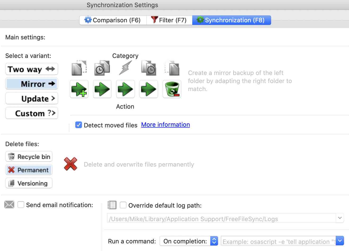

Yesterday, I downloaded and installed the latest version 11.1 for Mac Catalina and ran it to Mirror Sync files from my usual collection of folders in my environment to the OneDrive folder, still on my desktop. The OneDrive cloud was not connected.

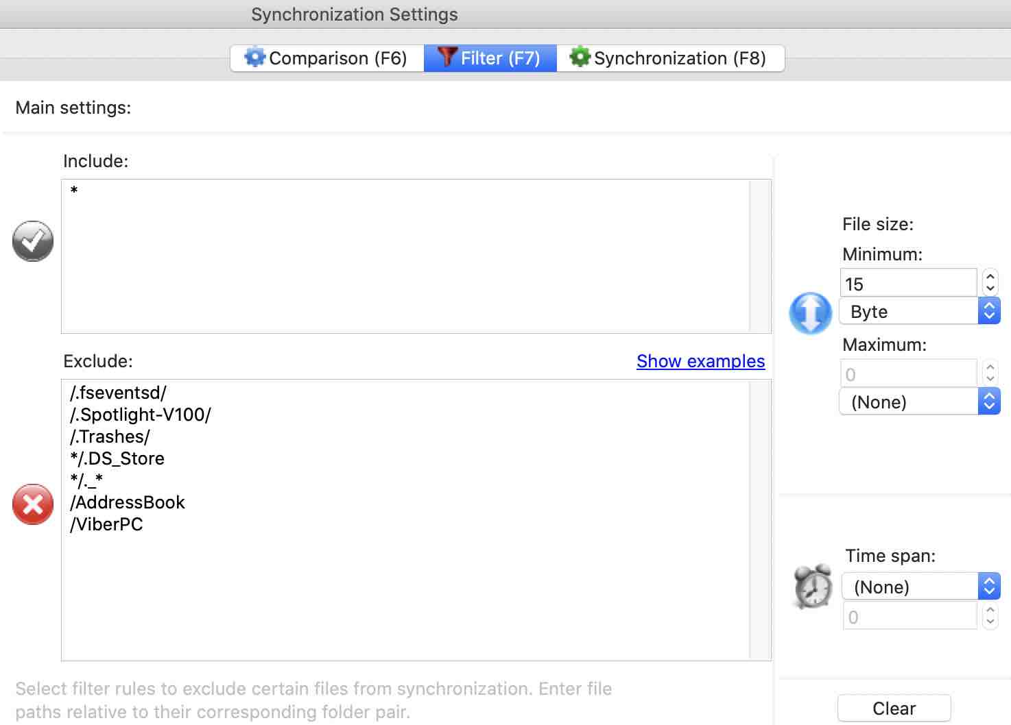

I include pics of my Filter and Synchronisation settings.

From here, I tried Mirror synching to my normal user environment where files and folders seemed to get nicely mirrored. However, the previously named folder "Unlawful Detainer case for eviction, RTC" was still there although it's contents had been removed! As on the Mac, I had the "Permanently Delete" option in the filter selected. Hope this can be fixed :-)
