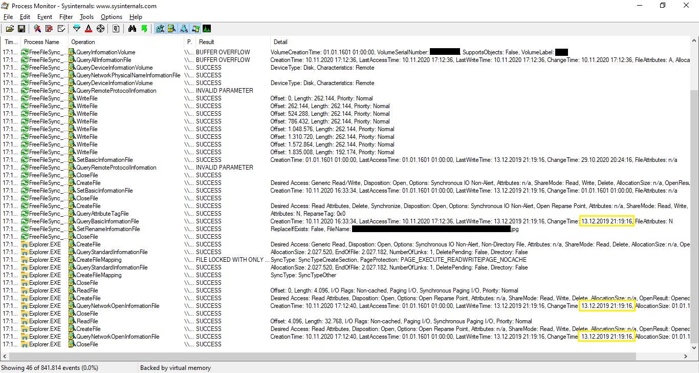

following the FAQ I used the process monitor to see what happens with the files. I made a sync and some files were transferred with correct modification time and some files were transferred with a modification time of the sync.
Here is a screenshot of the process monitor filtered to a file that was transferred correctly. In the yellow boxes you can see the correct modification time 13.12.2019 multiple times during FFS and Explorer action.

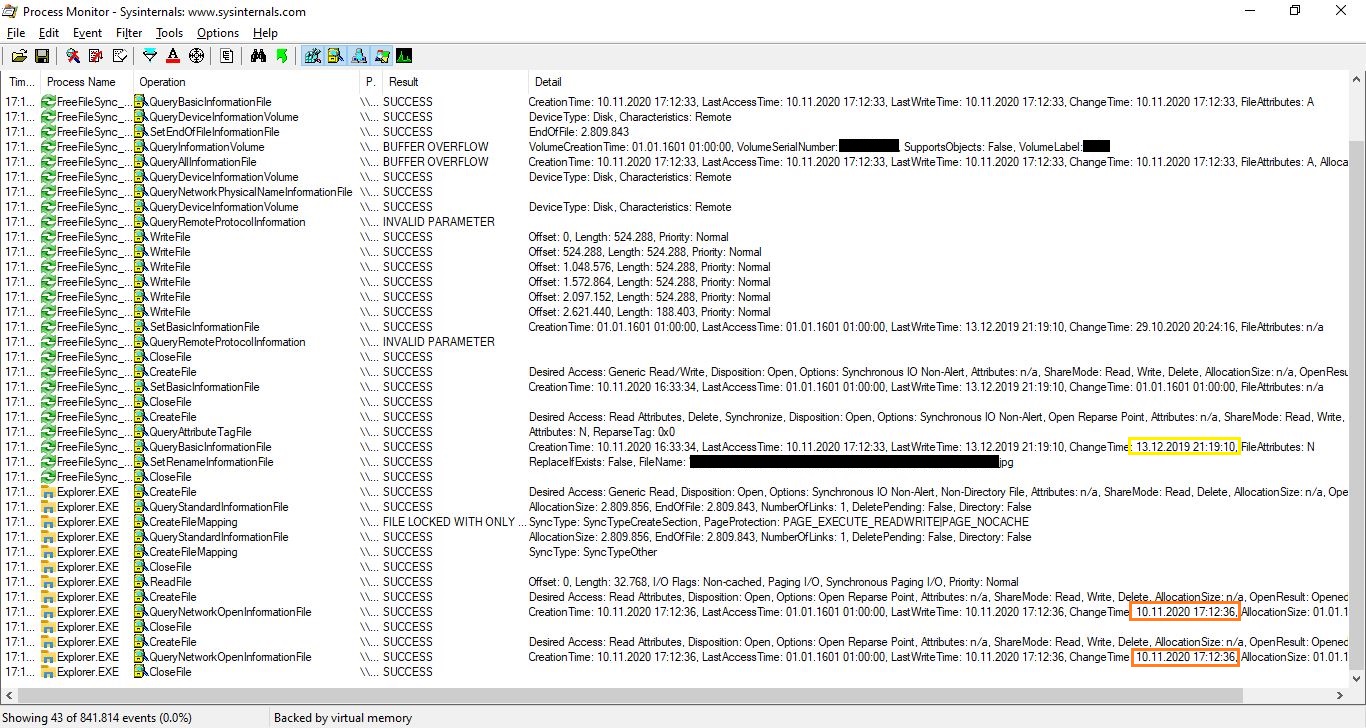

Then here is a screenshot of the process monitor filtered to a file that was transferred not correctly. In the yellow box you can see the correct modification time 13.12.2019 until the last three steps of FFS. Then after some Explorer action the modification time is 10.11.2020 in the red boxes. This is the date of the sync.
Could someone help me to find out what makes the difference? For me the actions seem very simular for both files.

(I'll just note that the LastWriteTime on the "failed" version is also current time.)
