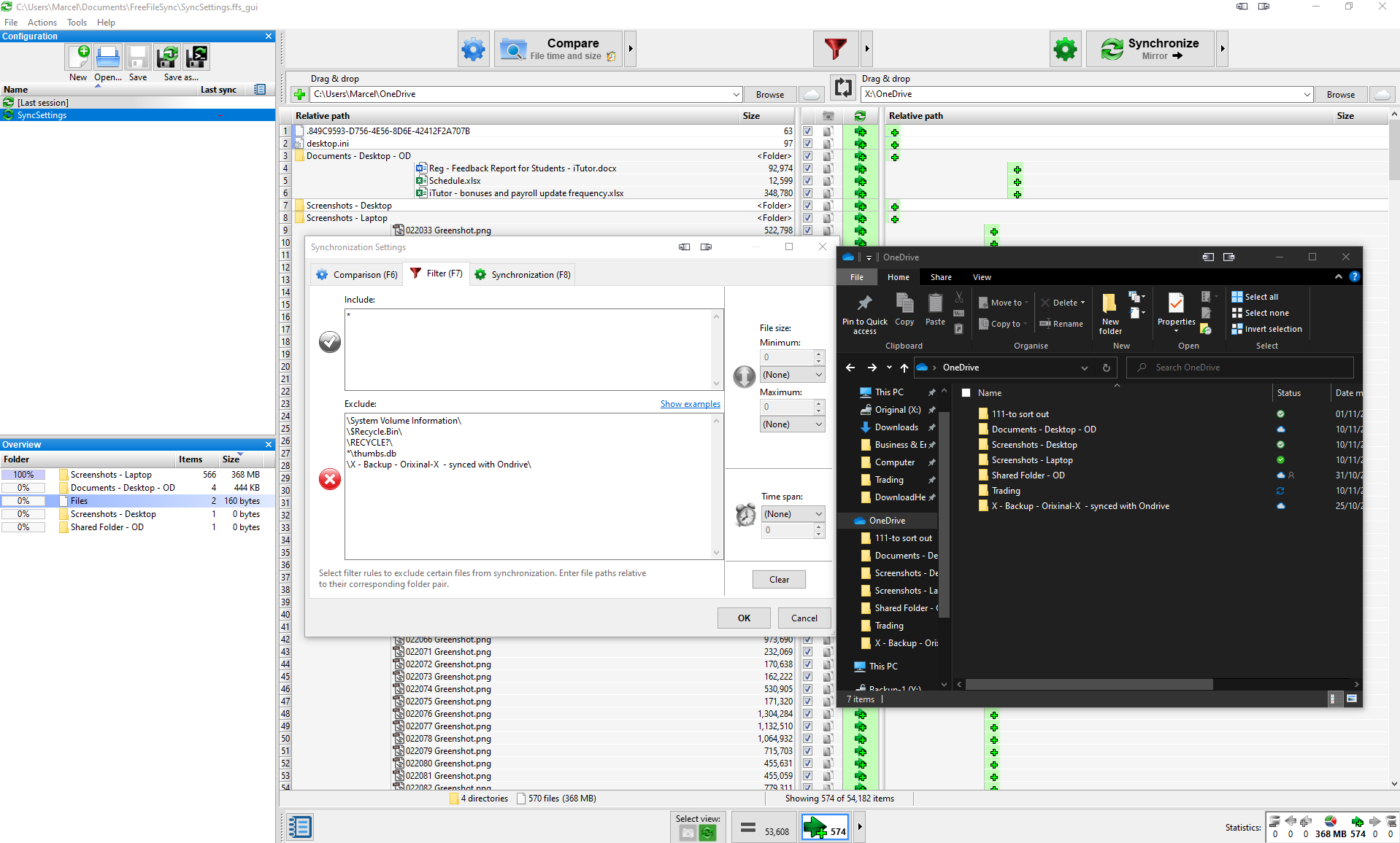

Two folders are not displayed after running a comparison on either side (left and right).
Both folders are located in OneDrive folder synced with the cloud and both contain 300+GB of data. Other folders and files in the OneDrive folder are displayed.
Folders that are not displayed are named:
111-to sort out
Trading
I attached a screenshot.
Thank you for your help!
Folders are not displayed after comparison

If there are no files in said two folders that require syncing, those files will not show up in your present Compare results view.
Try also making the equal files visible by clicking the "=" icon below the Compare results.
Those equal files are not shown by default, as they require no sync action.

Hi Plerry,
Thank you so much! Files in both folders were identical and required no action. The "=" made these equal files visible. Thanks a lot!
