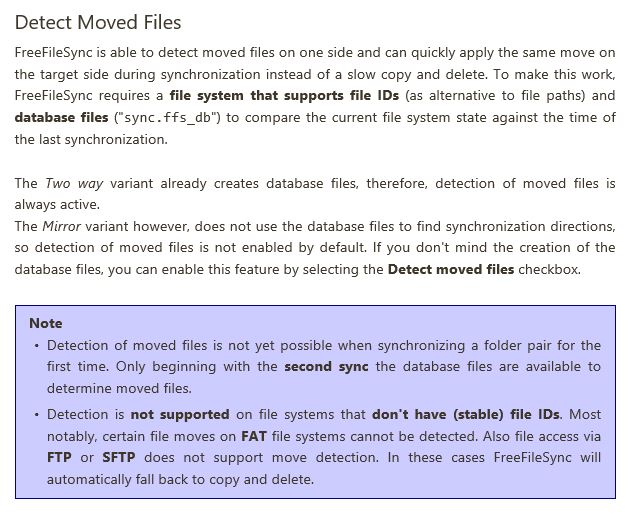

For anyone that is interested.
Attached is a screenshot found in the synchronization settings explanation. So folder synching is only supported for certain file system and doesn't happen the first time.

It is not "folder syncing" but "detection of moved files" that is only supported for certain file system and doesn't happen the first time.For anyone that is interested.
