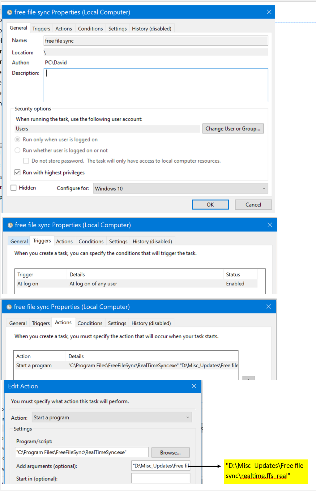

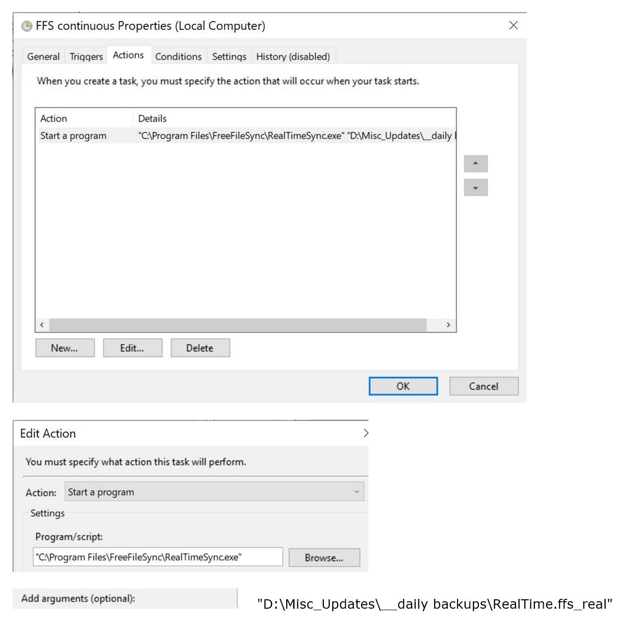

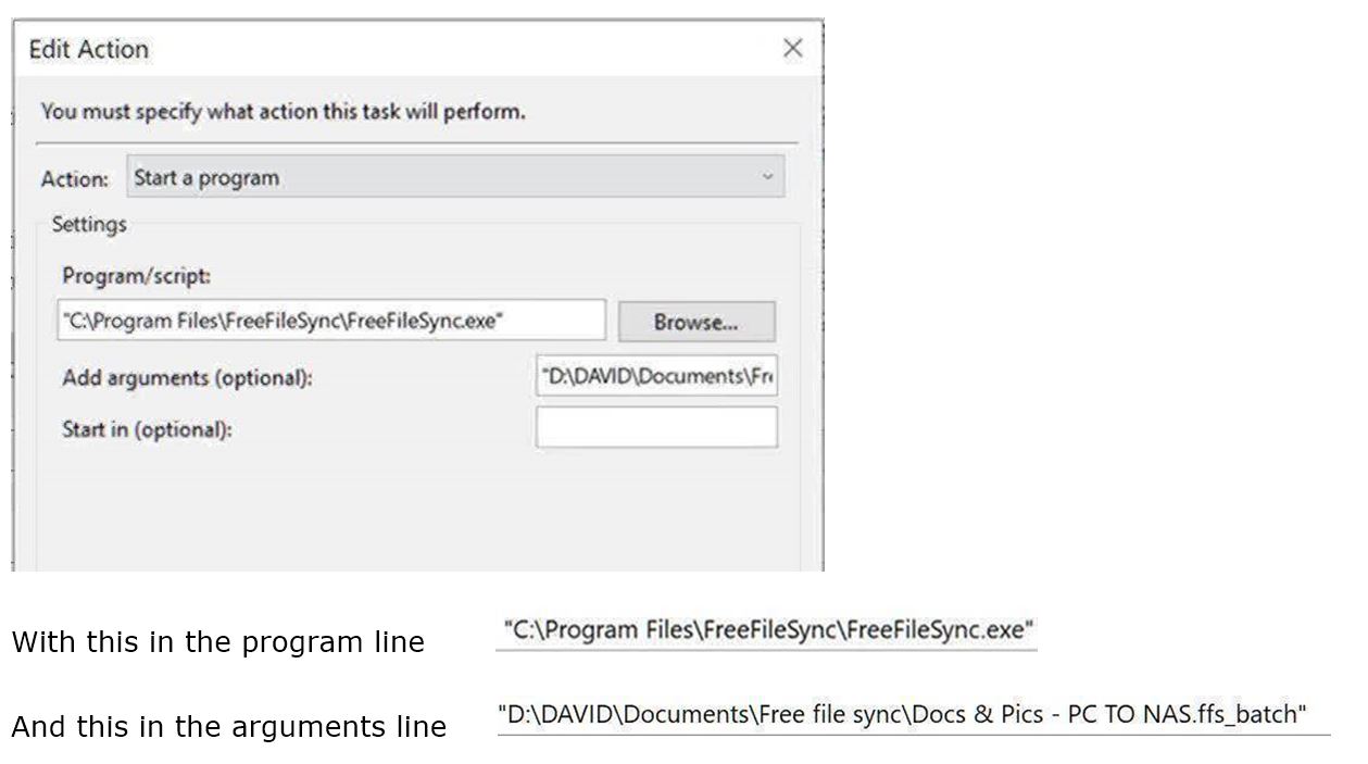

I have been running a nightly file sync for a few months, called from a batch file that is in turn triggered by a system task which wakes the PC (the batch file later triggers an Acronis backup task when FFS completes) and it all works fine
I recently attempted to create a task to run FFS in realtime backup mode, starting when the PC starts and failed

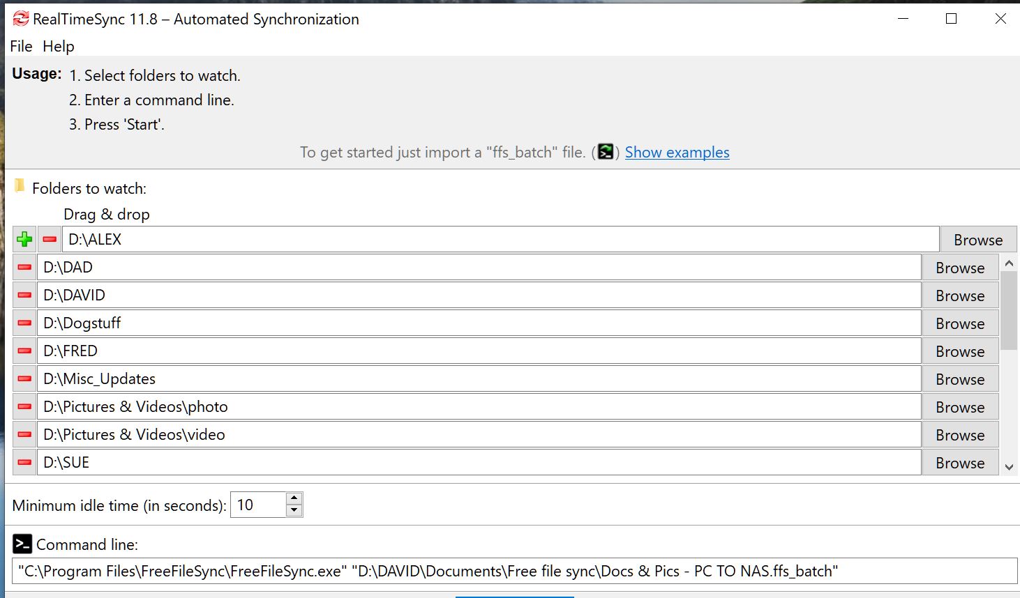

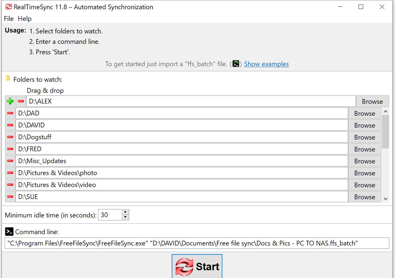

I followed the guides / examples in the help section and copied in my original ".ffs_batch" file
I call the realtimesync exe file with the task, additionally adding the location of the newly saved "realtime.ffs_real" file in the arguments section of the scheduled task as per the attached
I set the user account to be system
I do not use the UAC notifications which are turned off in control panel and always have been

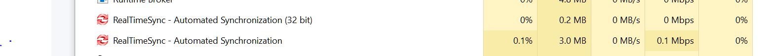

The task starts OK with the PC and two instances of realtime sync appear in task manager but it doesnt pick up any changes or create any sync entries if new test files are created
If I manually start the realtimesync program (the red icon) it both starts and picks up any changes as expected
I cannot see why it doesnt work with the task scheduler, I have set the task to run as windows 10 and also tried running with the the highest privileges which made no difference
running realtime backup as a task

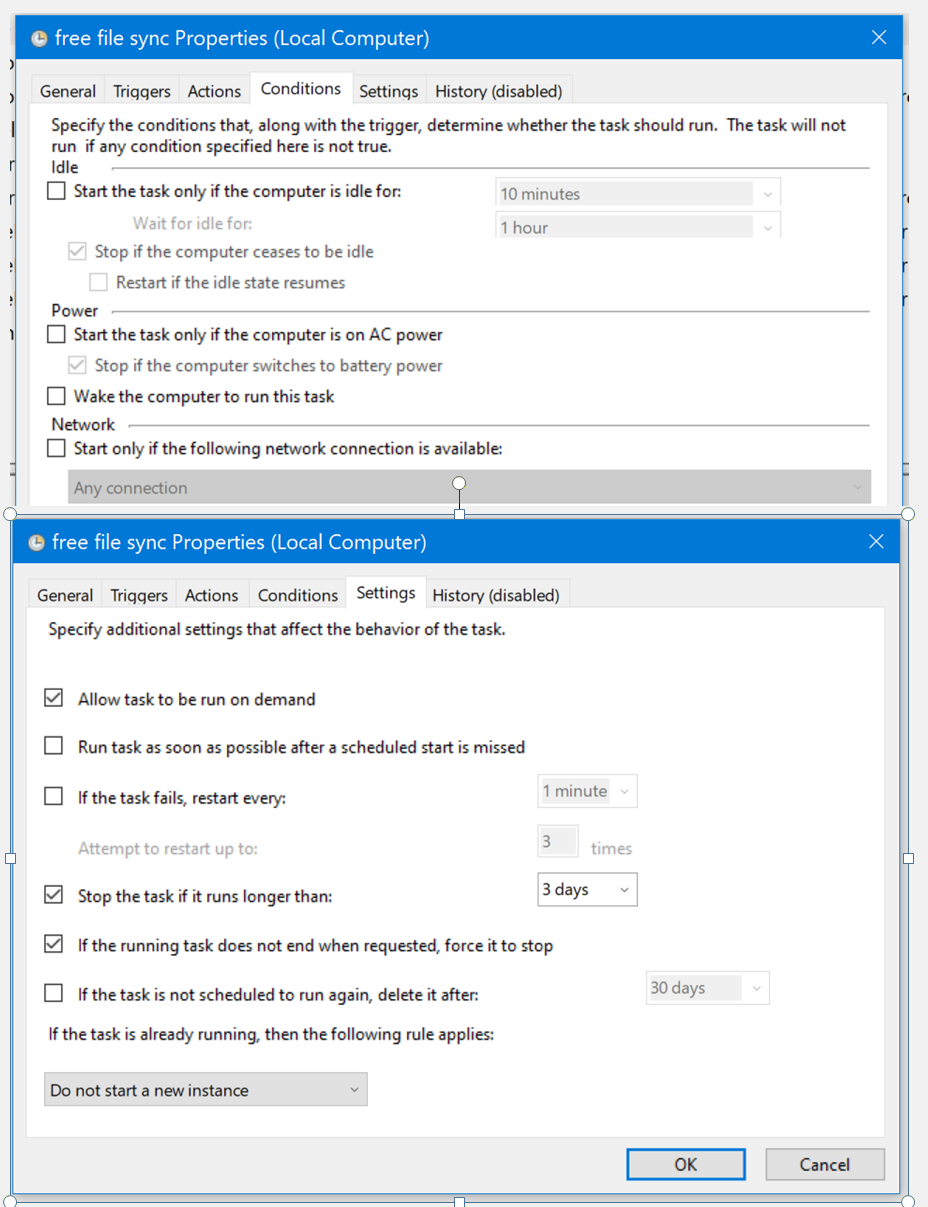

Your picture of Task scheduler shows you running FFS, not RTS. The picture labeled "2", the top one, looks correct, you need to save that as a .ffs_real file. Then in the task scheduler, you run "XXXX\RealTimeSync.exe" with the location to the .ffs_real file as the paramater
- Posts: 31
- Joined: 2 Oct 2019

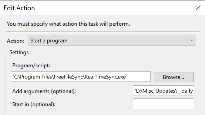

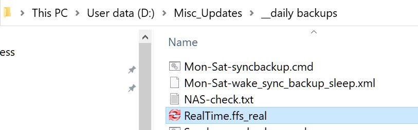

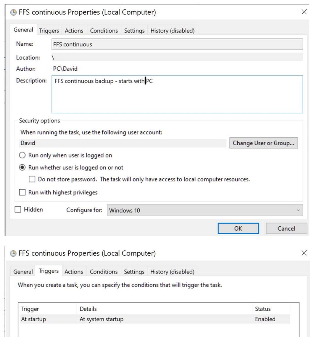

oops, made a bit of a mess of that - my apologies...I AM triggering RTS - I posted the wrong pics from earlier experimentation!.... I have also moved the file to another location (again posted incorrectly)....
This is the argument box content
"D:\Misc_Updates\__daily backups RealTime.ffs_real"
3 shows the correct task and 4 shows its' location
The task should run as the normal user that you log in with. You also mentioned two RTS icons showing up? Don't you only have the one config?
- Posts: 31
I meant two instances in task manager as here
Confirm that you are running the task as the user you are logged in as. If it works when you manually run it, it should work with a task
- Posts: 31
It seems to work if I set it as my user account but not if I set it as system - which is what the guide suggests ......
I was just trying to see if it worked or not. Since it did, that tells us your setup and commands are correct. SYSTEM must not have access to the locations you are trying to monitor/sync. You could leave it as your user if you only care if it runs while you are logged in. SYSTEM would allow it to run whenever since SYSTEM is always "logged in".

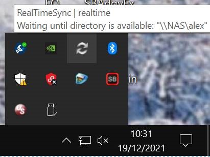

still having some issues with RTS...the (should be red) icon in the system tray shows grey and has a message that it is "waiting until directory xxxx becomes available" and obviously sync is not happening
I have re-arranged the folder list and proved that it is not any particular folder causing the problem
I am running the task as above and syncing to my NAS drive, which I can freely access from file explorer etc.
suddenly and for no apparant reason or time the icon will go red and the message disappears and sync happens
I am the only user logged in and have re-started the PC
If I close it and start a new session it is red straight away and sync happens

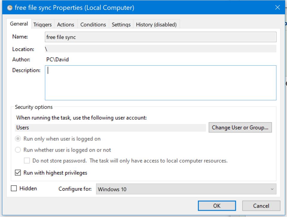

Are you running it with highest privileges, because it's been noted many times that you can't. That doesn't use your user account and probably doesn't have permissions.
- Posts: 31
sorry...when you say I cant, are you saying I cant do it or that it cant be done?
- Posts: 31
OK... "you cant because it doesnt work" !!
Having un-ticked the box it now, finally, WORKS :) :) :)

Yes, it can't be done, I don't doubt your skills! It just how Windows handles it, that's all.
