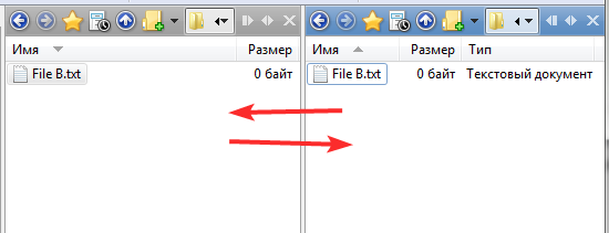

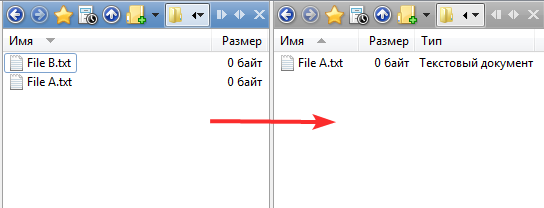

This is working Logic:
1. Create file
2. Sync and create NEW file after
3. Delete file on the right and sync
File deleted on the right will be deleted also on the left only if it was copied before
Feature request: Update profile with fss_db file
