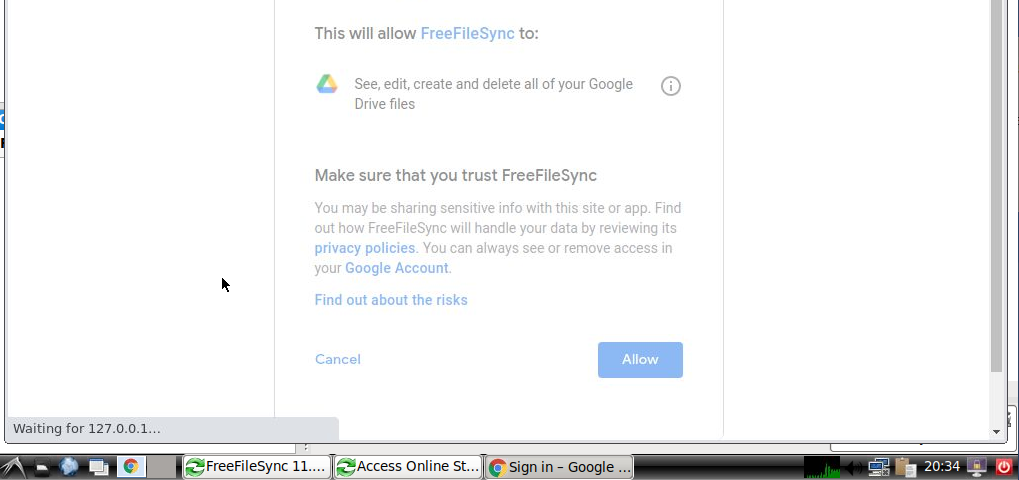

if I try to add connection for Google Drive in FFS the default browser starts, I am able to login to my Google account, but after pressing "allow" the browser only shows "Waiting for 127.0.0.1" (probably the local webinterface?) indefinetly.
I tried Firefox, Brave and Chrome - no difference...
My System is Lubuntu.
Is there any other way to authenticate FFS to Google Drive? Any other suggestions how to solve the issue?
It would be great to find a solution - this is my main Task of the setup: sync folders to Google Drive.

Does anybody have any suggestion? e.g. is it possible to authenticate google drive on another pc and transfer the "authentication" to the machine i have the issue with?
I am stuck right now... Would be great to receive some hints.

- Posts: 7535
Fixed! Thanks for your report:
https://www.mediafire.com/file/u4adf12kxddqomn/FreeFileSync_11.9_beta_Linux.tar.gz

Hi Zenju - thanks for the reply! Sounds good. I will try it after the release... I found a workaround this weekend:Fixed! Thanks for your report:
https://www.mediafire.com/file/u4adf12kxddqomn/FreeFileSync_11.9_beta_Linux.tar.gz Zenju, 21 Mar 2021, 17:33
I created a "sync job" on another PC (Windows) with Google Drive, copied the Job to the Linux machine, logged into the Google account in chrome, opened the "sync job" in FFS --> FFS asked for the authentication in chrome --> after granting the access in the browser the authentication worked!
