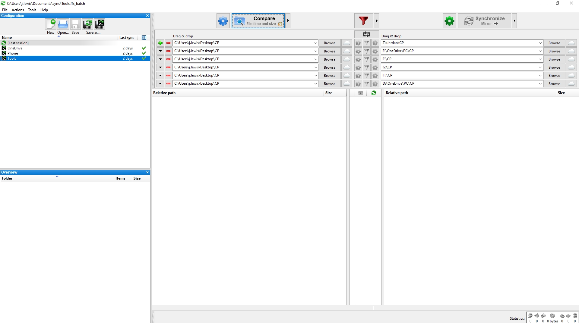

No, it is possible to have multiple RTS instances running. I have four running simultaneously. There is just no reason to have two RTS sessions monitoring the same locations just to mirror one source drive to two destinations. You should just set up a batch job that has two pairs of locations, both sources will be the same of course, and the destinations will be the two backup locations.
See my attached picture. I have one folder that I am syncing to many locations. RTS is monitoring the source folder so that any changes I make will get mirrored to every one of those destinations.

Thanks a lot. I‘ve tried the sync to different targets - it works. :)
