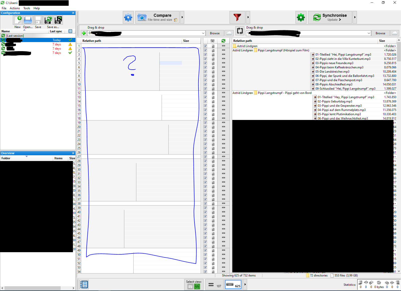

In the FFS comparison view there are lines without any text. There is content in these lines since the hover effect show it. However this problem makes FFS unusable for me. Please have a look to the attached screen shot.

That is because those files do not exist on the left side but your settings are set to no do anything when that happens. You are likely using the 'update' sync method. When you hover of those lines, it it showing you the location on the left that would be equivalent to your right-side location.

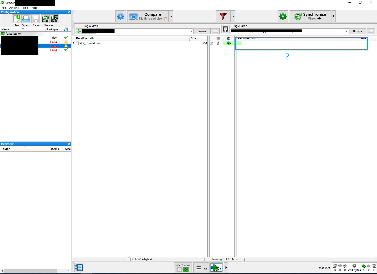

Please have a look to my second example. Is this also expected behaviour and does it mean, that not existing files will visualized like this in any case, independent if there are on the source or destination side?

Yes, that is currently how it is supposed to work. There is another thread on here discussing the layout
