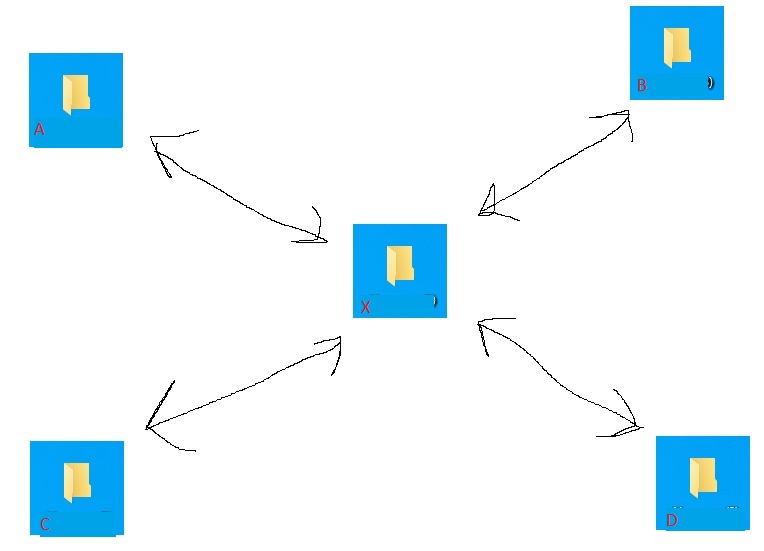

Hi I would like to sync 4 folders, so it is always the same in them. if it changes in a folder, everyone must be updated. Is this solvable?
have tested as in the picture. But then something goes wrong. so anyone have any solution?
this is for my ARK servers that need to sync files in between
sync 4 folders

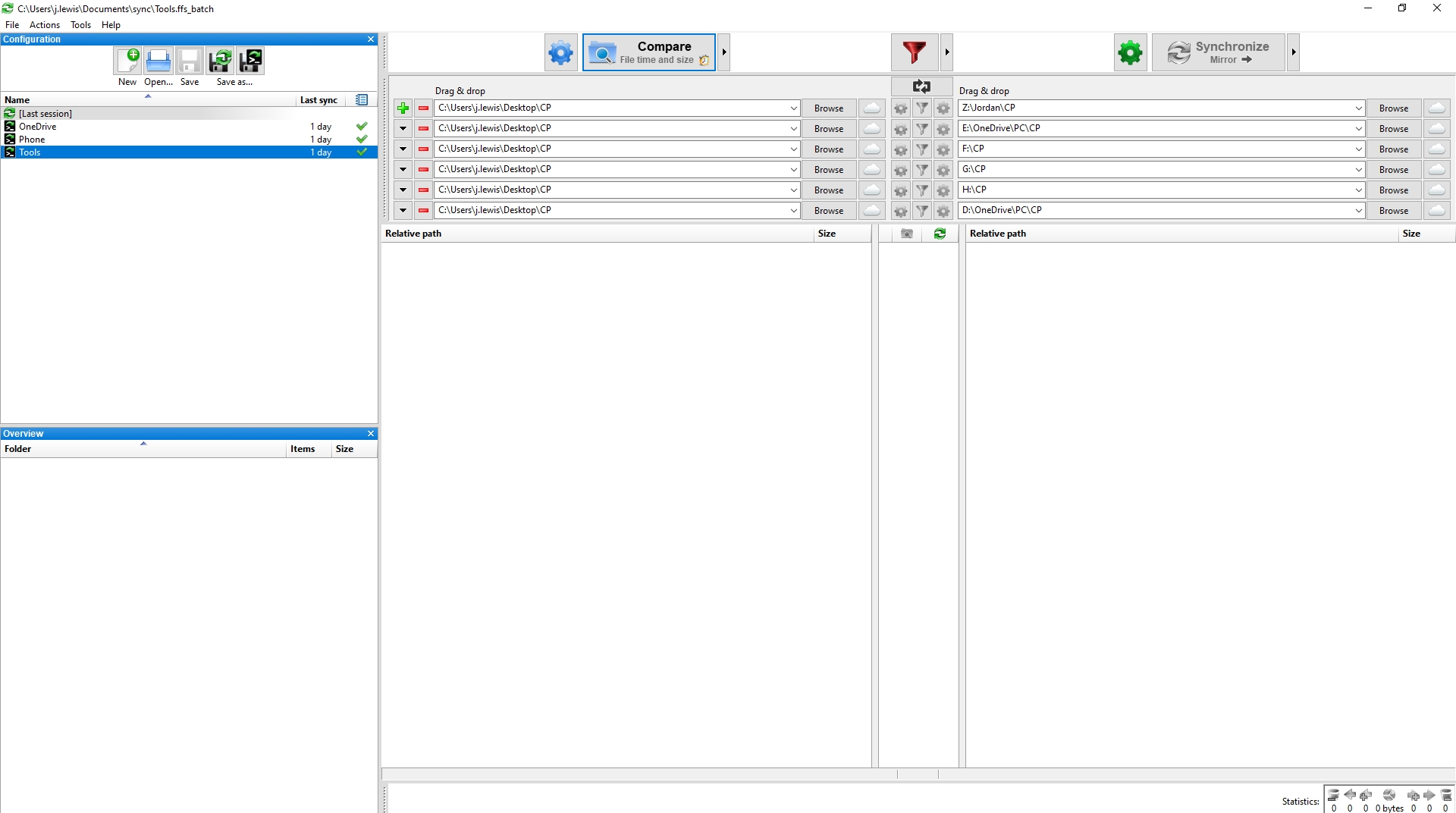

I sync a single folder to 6 different destinations without fail.
Attaching a picture of my folder pairs. They are all set as "mirror"
2021-04-14 11_22_19-C__Users_j.lewis_Documents_sync_Tools.ffs_batch.jpg xCSxXenon, 14 Apr 2021, 15:22
>That's pretty vague.
>On what machine(s) is FreeFileSync (FFS) running?
>And what FFS configuration did you use?
on one PC
was a while since I tested, but probably tried both Two way and Custom
>Even more vague. What goes wrong?
>What does/do the FFS log-file(s) tell you?
ffs log said nothing. what I remember
what happened was that the files were overwritten in the wrong order. so ARK could not read them
>FFS seems a perfect fit for your use case.
>For more specific advice it is important to know where changes to the synced files/folders can originate >(only on X?, only on A?, on any of the machines?). And on which machine(s) you want to (or can) run FFS.
What I want to do is have 4 folders that all should always have the same files.
if it changes in any of them, all must be updated.
and the change will only happen in one folder at a time.
Anyone have a solution to this?
folder x I had only as a buffer. but did not work

Oh I see! I took it as any change made in your middle folder would be synced to the others. The easy way is to make a sync that has three pairs:
A - B
A - C
A - D
Then have all three as a "two way" sync. That way if any changes are made in B/C/D, you will run the sync so that those changes get applied to A, then run it again to then apply those changes in A to the other two remaining folders. If changes are made in A, only one sync will be required of course.

Will it work?
Because you need a solution that constantly monitors A B C D. and as soon as a change is made in one of the folders, everyone must be updated!
Will your solution work?
The second solution I proposed will not work. If a file gets deleted in "D", then it will delete it from "A", but since it exists in "B" and "C" still, it copies it back to "D".
The first solution is the only one I can see that works so far.
You could create two identical syncs, one that runs the other after completion. Then RTS will run the first pass, that calls the second, mirroring the data across all four folders
