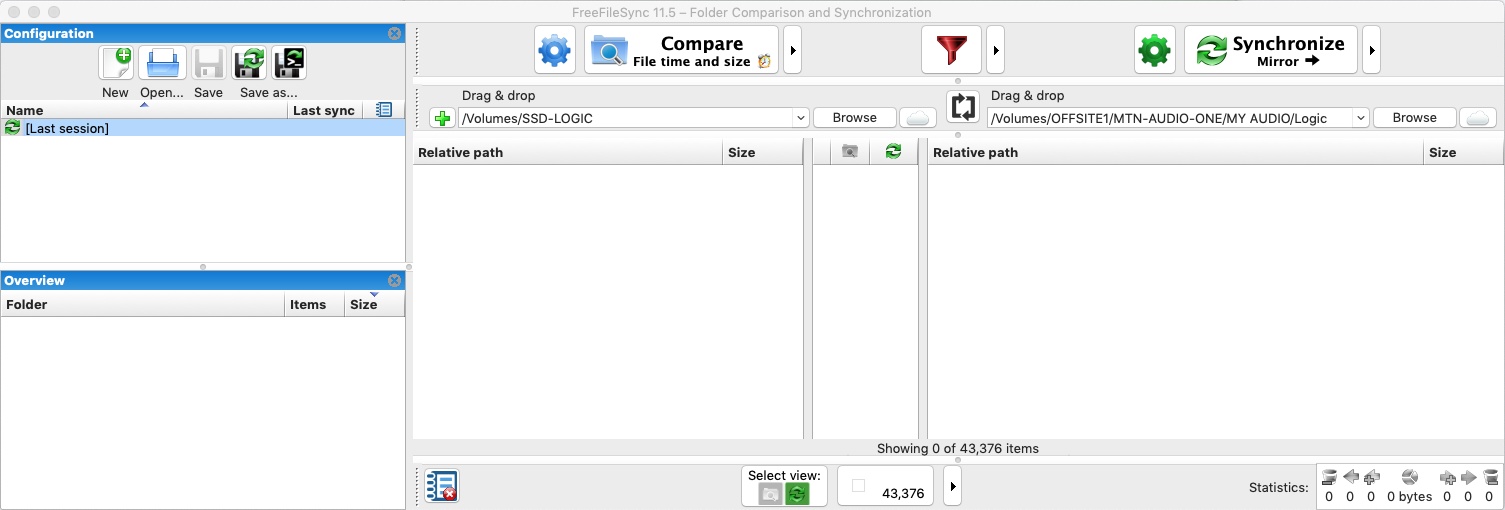

always worked before with these 2 external drives that are my occasional backup drives - still working for other external that are my primary daily backup drives. I hit Compare FFS runs a process then both panes are blank. Any ideas why?

they are different. the external has not been sync'd for over a month. attached is what it looks like after running process.
You "log file" has an X mark on it.
What does it say (F4)?
- Posts: 8
- Joined: 25 Oct 2020
Those errors are unrelated...all other drives work with those ignored errors. They are just a system file on source drive.
Check your settings, Filters.
Having an Exclude: filter of '*' will give you "results" like you're showing.

current =
Include:
Exclude:
/.fseventsd/
/.Spotlight-V100/
/.Trashes/
*/.DS_Store
*/._.*
*/$RECYCLE.BIN/
Include:
Exclude:
/.fseventsd/
/.Spotlight-V100/
/.Trashes/
*/.DS_Store
*/._.*
*/$RECYCLE.BIN/
What if you click "browse" and re-select the locations?
