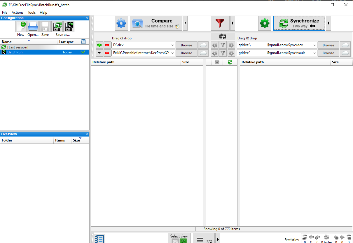

I have this setup
which is running good but i want to use realtime sync for monitoring.

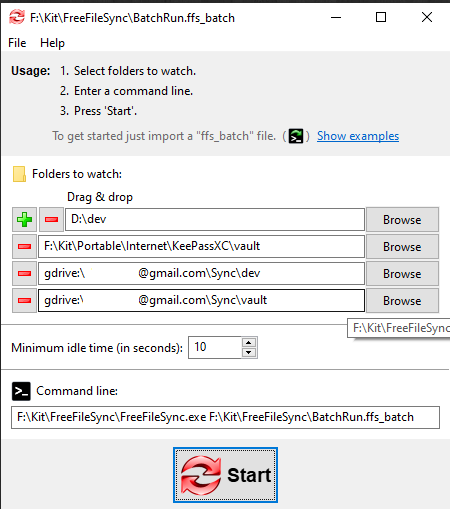

I put realtimesync.exe link in startup folder with no parameters
when my system starts, i get this error
and my setup is as follows:
If i remove the last 2 lines, realtimesync is working good.
After reboot, again, the last 2 lone appear again and i get a sync error.
What can I do to obtain a error free setup?
Thank's
Posts: 2946
The error message already tells you:
Gdrive does not support directory monitoring (or at least the type of directory monitoring used by RealTimeSync).
So, you can monitor the relevant (sub)folders in your F-drive for changes, but not your Gdrive.
Whenever a change in the monitored part of your F-drive triggers the *.ffs_batch sync to be run, any changes that meanwhile may have occurred in your Gdrive will then obviously still be synced, but will not trigger a sync to be run.
Posts: 4867
So I see you already figured out that removing the drive monitoring works fine, but sounds like the problem is that they come back after a restart of the machine. Make sure you save the new configuration and update you startup location that the RTS file is bein called from. It is probably opening the original config which contains the gdrive locations, obviously

So I see you already figured out that removing the drive monitoring works fine, but sounds like the problem is that they come back after a restart of the machine. Make sure you save the new configuration and update you startup location that the RTS file is bein called from. It is probably opening the original config which contains the gdrive locations, obviously xCSxXenon, 01 Jun 2021, 14:17
Thank's Xenon. Is working like a charm :)
