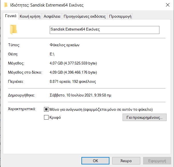

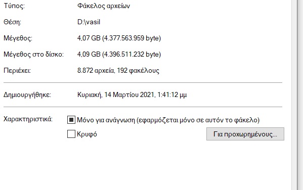

Hello.I am starting from yesterday to use free fiel sync.I use mirror option for creating backup for two folders of my internal hdd(my laptop has two drives an ssd and and an hdd which i used as storage).The right folder for the creation of backup is san disk usb stick.For the first back which is all my documents i see the same number of files/folders left and right.For the second backup which is my pictures appears one less to right folder.I try compare setting but i don't know if and how to see if missing one file.I have the free version.

You don't need logs, it is probably just the 'desktop.ini' file. FFS has a set of filters to exclude items that are unnecessary and bad for performance to backup. If you remove the exclusion filters and compare, you will see the file that is 'missing'
Posts: 4949
With that said, I would just leave it or reset it to default after satisfying your curiosity
