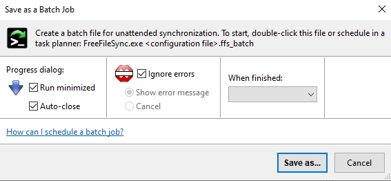

Yes, it pops up after every single Job.
When you saved your batch file in FFS, you needed to check "Run Minimized" and "Auto Close", and "ignore errors" if you want. Open FFS, select your sync, click "save as" and overwrite it after checking those boxes.

Perfekt, it works finde. Only a litte cosmetic problem is
left. After the laptop is started, the batch-file opens up.
This might be related to Windows, I guess.
Many thanks for your help, you saved my life.
No, you must have missed the "Run minimized" box. RTS will always run the sync once before going idle. I have Windows and don't have that issue

I did mark minimised and then automaticly auto close and ignore errors were set. Okay, tomorrow I'll start from scrach and let you know if it works.
Or, you put the batch file in your startup location too? You don't want to do that
- Posts: 11
- Joined: 24 Jul 2021
It's in the autostart, as proposed in some kind of manual I found in the internet. Plus I placed a copy in my documenta, but not as a .bat
Just the RTS file goes in your startup.
Move your batch file somewhere else and make sure you modify your RTS config to run the batch in the new location also

You need to keep the batch file. All RTS does is run the command after detecting changes. The command itself runs FFS with the batch file you set up.

- Create your sync setup in FFS
- Save as batch file "xxxxxx.ffs_batch" in your documents or wherever you want, as long as it's not in startup
- Open RTS and drag that batch file onto the window so it auto-fills all the info.
- Change idle time if needed, save RTS as xxxxxx.ffs_real in your startup folder
- Done
- Done

Okay, I got it done and it works perfekt.
