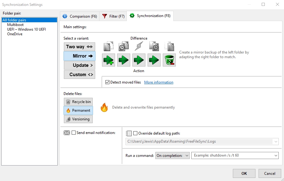

Posts: 4946
Well yeah, but I actually was referring to a built-in option for FFS
Bottom right of the sync settings
