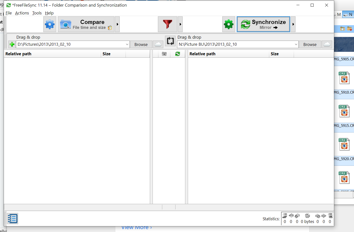

Run a compare and post a screenshot of the FFS window

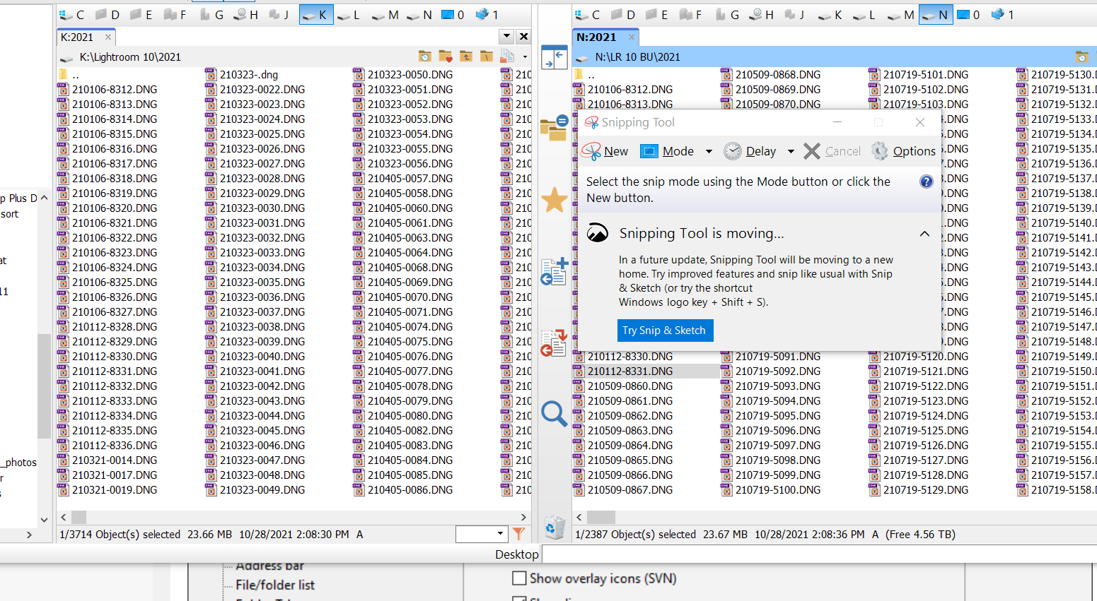

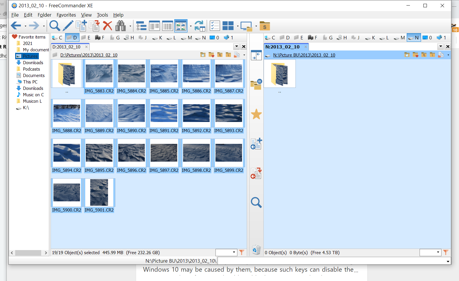

Sorry for the late responce. My print screen will not work. By the time I get the snipping tool in place the phrase "no files to sync" shows up and disappears. The screen shots are of the FFS and my file handler. I took several images out of the folder on the n: drive. The other shot shows the comparison between the d drive which has not been changed to the folder in the n drive where i moved some files for the test. Before the test both folders were synced. These are BUs of image files. The compare function on the file handler had it right showing the files i moved for test.
So "test sunday 2" is the FFS window after running a compare?
