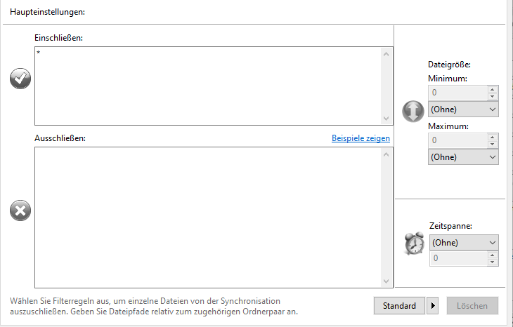

I have defined several sync pairs and run some of them at the same time. So far everything has always worked. I'm syncing some directories with nextcloud and I notice that there are many files of the form ".<original filename>.<some genereated suffix>". Now I would like to exclude these globally, which somehow does not work. Here is the corresponding section of globalsettings.xml:

If I call multiple sync pairs, I see all files that should be excluded with "*\.*.*". If I display the global filter (see attachement), then include is "*" and exclude is empty. If I now add exactly "*\.*.*" to exclude, then the files are excluded as expected.
Screenshot 2021-12-10 155456.png (23.91 KiB) Viewed 1250 times

On the filters tab, there is a button in the bottom-right to save/load filter templates. Here you can change the default so that every new config going forward uses your custom settings.

Thanks for your reply. I have already been there and made some modifications, but now I noticed that I can/must load the global settings via the Default button for them to be active. I assumed that these settings are always loaded by "default" as the name of the button suggests. I guess that was my misunderstanding.
