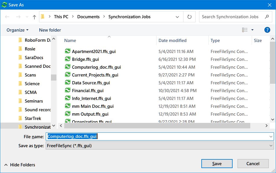

Thank you for your reply. When I select & click Save as..., I don't see any options for auto-close.
![Image]()

Additional: all my jobs now auto-close. I even created a new job, named it test, & it auto-closed. In fact, when I put the same to folders in the sync drag & drop boxes & saved it with a new name, it automatically synced only the same files.
You have to save them as batch jobs, not regular configs. When you click "save as batch job" you'll get the option to auto-close or not. AFAIK, all .ffs_gui configs will auto-close when ran via command line
