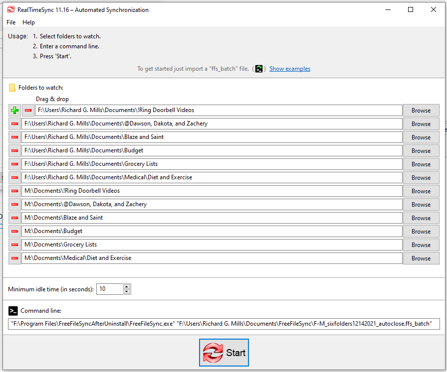

I can't find any answers to this, and all posts on the subject are a few years old. RealTimeSync was working fine. Recently, it stopped working with the batch file I was using. Today, I tried various one-directory matches, and it doesn't matter which file I try, I get the same error (as listed on this site a few times):
Cannot monitor directory "[directory path and name]". ERROR_FILE_NOT_FOUND: The system cannot find the file specified. [GetOverlappedResult]
When I run the same batch on FreeFileSync (Version 11.16 • 64 Bit • 1/2/2022), it completes without errors. But when I try to run it in RealTimeSync (Version 11.16 • 64 Bit • 1/2/2022), it won't work.

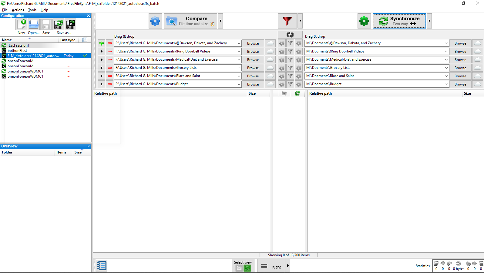

When I run the batch file in FFS, it completes successfully. When I run the same batch file in RTS, I get that error message. If the comparison folders are on the same PC or two networked PCs, they complete in RTS. If the comparison files are on either PC to the MyCloud ethernet-connected drive, I get the above error. The original batch file I was using was between my main PC and my MyCloud, and it functioned correctly for months. Recently, it started producing the above error and won't sync. I experimented with individual folders from the original batch, and each one produced the above error in RTS, so it wasn't a folder issue. I then created test folders of only one document, and the same thing happens: FFS completes without error; RTS immediately produces the above error.

Attach a screenshot of your RTS config window
