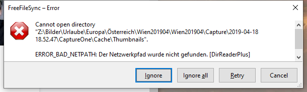

I am using FreeFileSync to keep files on my main PC in sync with those on a directory on my NAS, which is mounted as a network drive under Windows. Basically, this works, but recently I get more and more error messages like the one in the following screenshot. It doesn't happen every day, but if it does, it just doesn't run through.
I tried to open this directory on the NAS using the Windows explorer. This was possible without any problem.

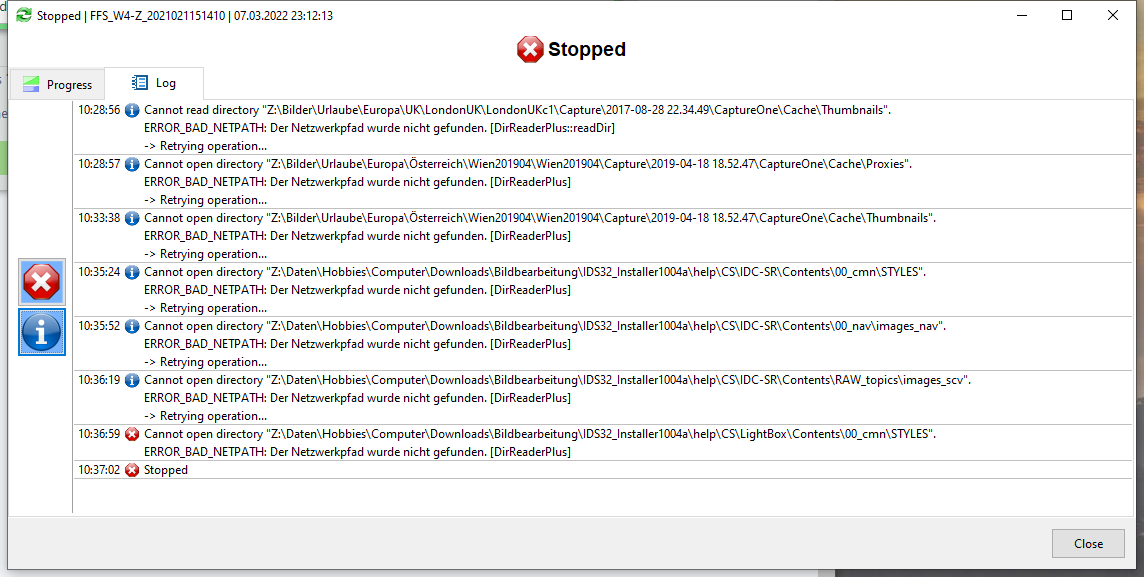

So I clicked "Retry". But FFS gave me the same error message again, almost instantly. But it listed a different directory that it couldn't open.
Question 1: Do you agree that the fact that it did not list the same directly once more as "could not open" means, that it could read it after I clicked "Retry"? Why couldn't it read it the on the first try then???
I kept clicking "Retry" many times (when I first examined this error), but FFS kept listing directories it "could not read". It seems that once it ran into this issue, it can't get out of it. I also clicked "Ignore" and "Ignore all" on other instances, but it always kept showing new error messages and eventually stopped.
I verified that all the directories shown in the screenshot above could be read without issues by the Windows explorer.
Question 2: How can I get FFS back to work without these issues?

It seems you're using parallel file operations. Then there was a temporary network drop, and all parallel operations failed at the same time. But only one of them is reported at a time. So when you click retry to dismiss the first error message, the next error in queue comes up, even though at the time you're clicking, the temporary network issue is probably already gone.Question 1: Do you agree that the fact that it did not list the same directly once more as "could not open" means, that it could read it after I clicked "Retry"? Why couldn't it read it the on the first try then???
I kept clicking "Retry" many times (when I first examined this error), but FFS kept listing directories it "could not read". It seems that once it ran into this issue, it can't get out of it. I also clicked "Ignore" and "Ignore all" on other instances, but it always kept showing new error messages and eventually stopped. wus, 08 Mar 2022, 10:14
Solution: use automatic retry (maybe retry once with a few seconds delay).
