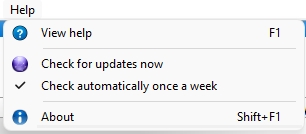

I just got the newest Donation Edition for Windows. I thought I'd see a setting that would allow for Automatic Updates, but I don't see it.
Thanks in advance
Is there a checkbox for Automatic Updates?
- Posts: 6
- Joined: 20 Feb 2020
Help -> Check automatically once a week.

If your donation period is not expired, and you are running the donation edition, it will auto update to the latest donation edition. As Zenju stated, if you manually updated FFS using a non-donation installer, you are no longer using the donation edition and auto-updating won't even be an option until you install your donation edition overtop the current, non-donation, installation. The only way to "lose" it, as you said, is to manually install the regular version, as Zenju said.
Under help, there is the option for automatic updates.
