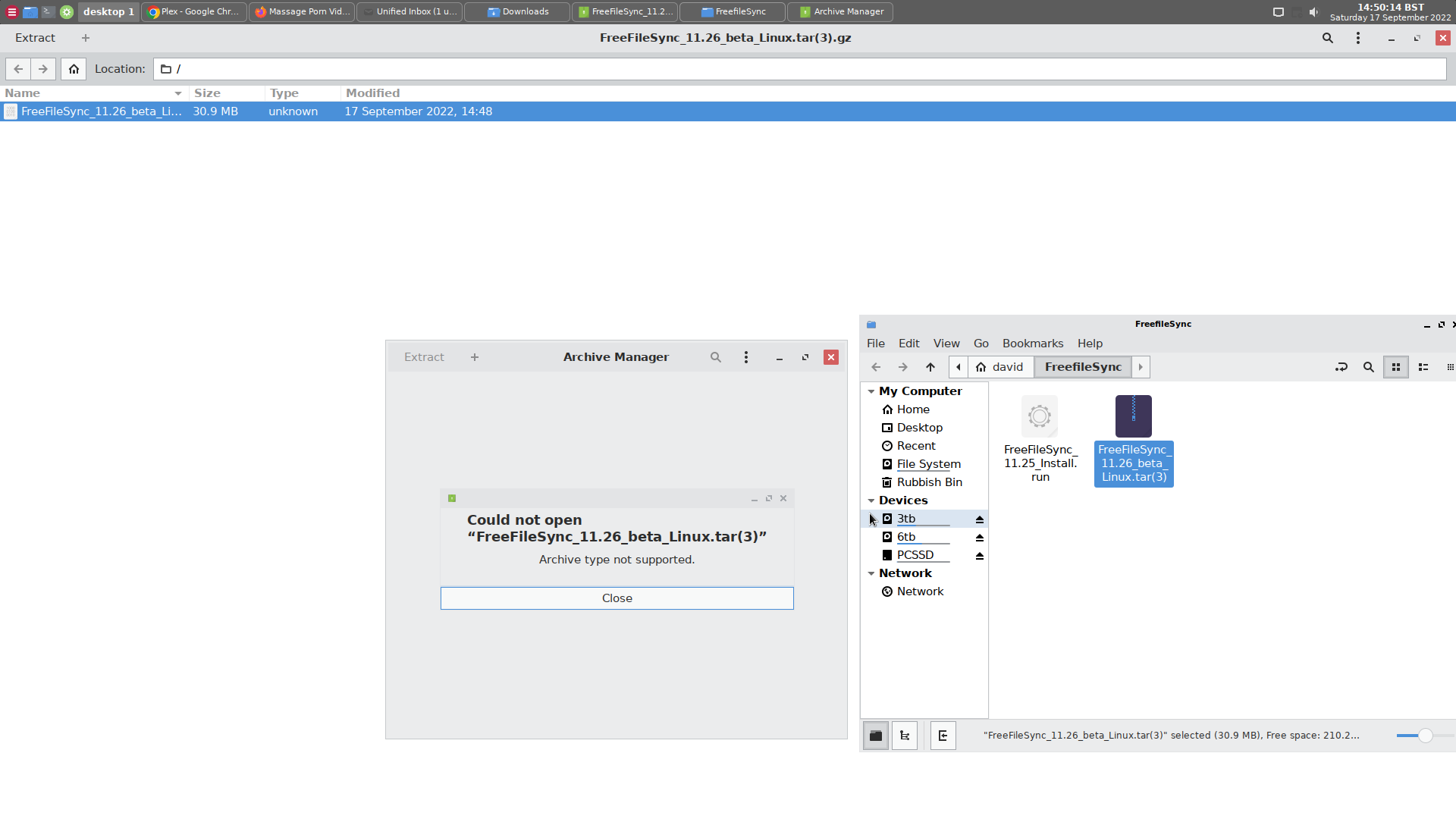

- Joined: 1 Mar 2020
Not with my installation.
NB didn't work under default pcmanfm either same result archive not recognised
Please remove the "(3)" part from the file name and try again.
- Posts: 22
Did so = All good; works absolutely fine straightaway
Awesome! So adding support for lxterminal fixed it.
