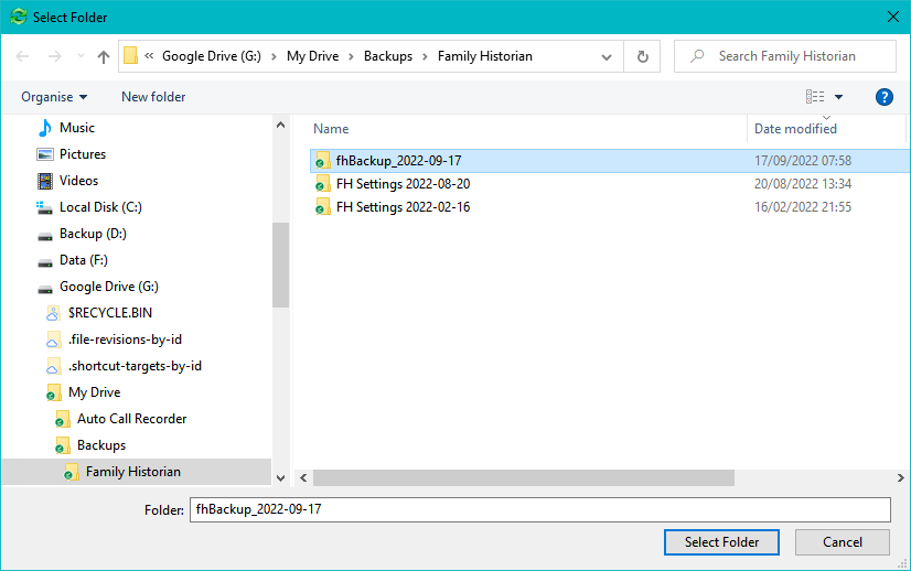

Update: FFS sees the folder structure when I click the browse button but whatever directory I pick on the Google drive the left hand panel remains empty.

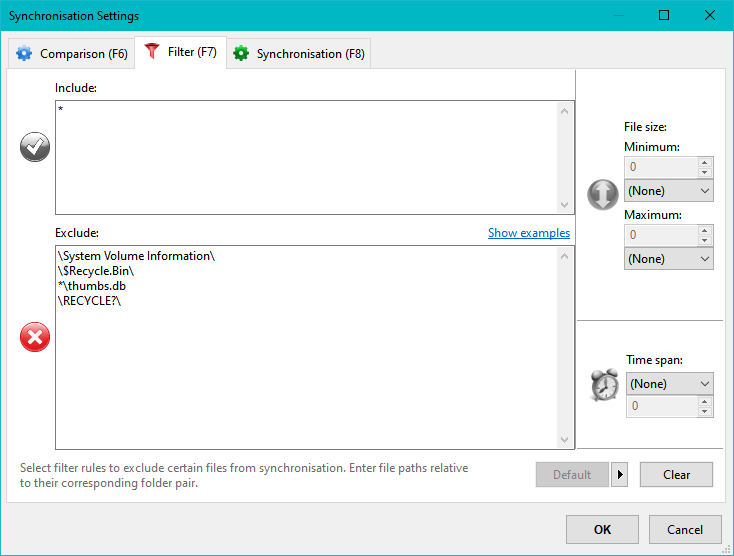

Posts: 4946
I get that, but you aren't using the Google Drive feature built into FFS, so Google drive is irrelevant for the problem that is occurring. The issue is that FFS is seeing the location as empty even though there is data in it. Can you screenshot your filter settings in FFS and post it? Also, run a compare and screenshot the results and post it, even if the results are empty.

Filter:

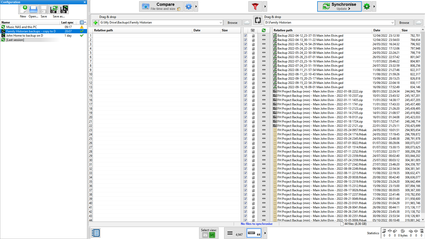

Compare:
As you can see Browse can see the directory structure:

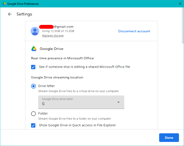

You are wrong, it is everything to do with Google Drive. G: is not a drive in a partition on the hard disk like my C: and D: drives. It is a virtual drive created by Google Drive. If Google Drive isn't running the G: drive doesn't exist.

What are your synchronization settings? Your compare window is showing that everything is in sync but that there are files in D:\ that don't exist in G:\, and it looks like your settings are set to do nothing when a file only exists on the right side. If you click that box below with the equal sign in it, you will see the data in G:\, but it is already synced to D:\

I'm using Update which copies new and changed files left to right.
The backups folder on Google just contains the last few backups (I only have the free 15GB Google drive). This sync means I keep a permanent archive of all backups on my hard disk (where I have stacks of free space). It is scheduled to run 5 minutes after logging in so I archive the backup of what I did the previous day.

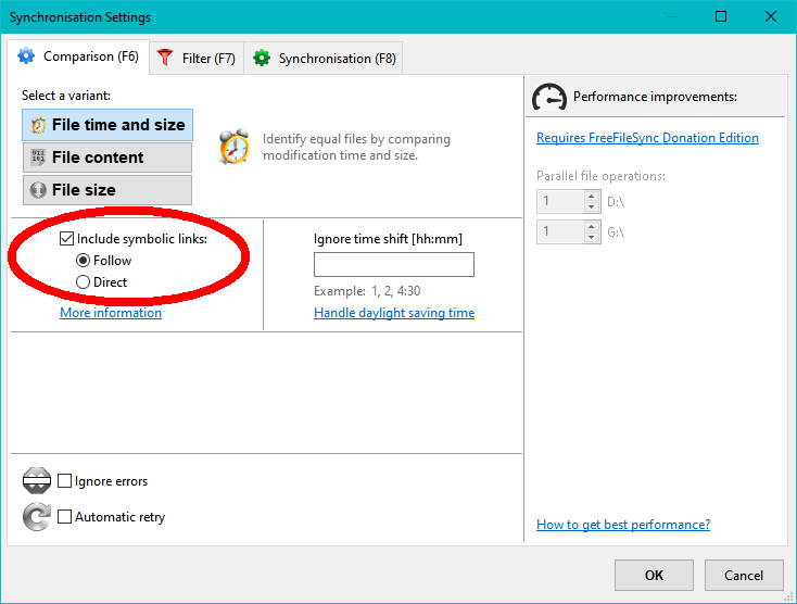

Cracked it!
It needed a change to the Synchronisation settings:

The mystery is why it was working up to mid September without that option on!
