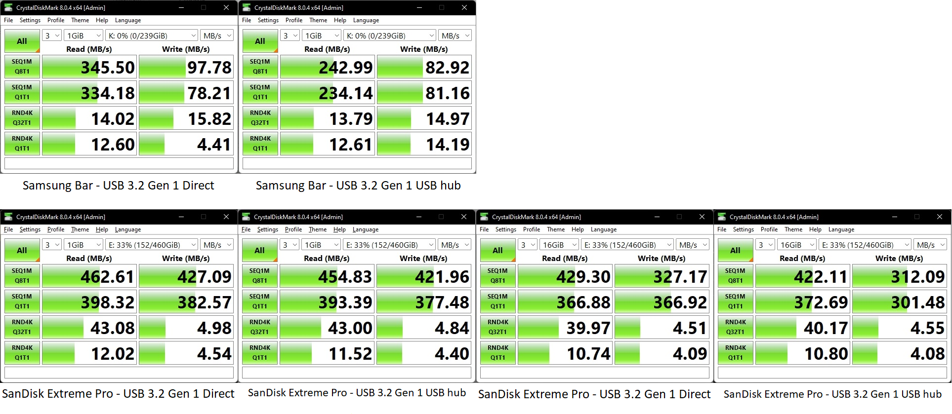

I have been using the new flash drive for a week. I am thrilled with it! It will write at 300MB/s +, which writing is my absolute highest priority. When I ran a sync of 150GB+, the average speed over the whole transfer was 135MB/s. There was a mix of large files and small files. When transferring only larger files, it is consistently over 300MB/s. It is about 3x the size of the Samsung Bar I was using, but I will never ever go back daily-driving a regular flash drive.
I will attach some results of CDM tests using the default 1GB size and 16GB size, as well as using a hub vs direct connection. I did not test the Samsung Bar at 16GB test sizes because it was so much slower that I didn't care to let it finish. Both are formatted exFAT.
The highlights are:
- No significant difference in read/write speed when using the SanDisk on a hub versus direct connection. The Samsung Bar drops 100MB/s in the Sequential tests when using the hub.
- The write speed of the SanDisk is 436% faster than the Samsung Bar for the 1GB test.
- The write speed of the SanDisk in the 16GB test, after the cache fills, is 334% faster than the Samsung Bar in the 1GB test, which is under the cache size for my 256GB version.
- The random 4k tests @ 32 tasks in the queue is handled three times as fast when reading from the SanDisk.
- Random 4k tests @ 1 task in the queue was basically a wash except when the Samsung was in the hub, I don't know what that is all about.
- The max size, 64GB, on the SanDisk produced identical results at the 16GB test, within margin of error.
In real use, the SanDisk is lightyears ahead of everything else I have used and will pay for itself if you use it for work.
