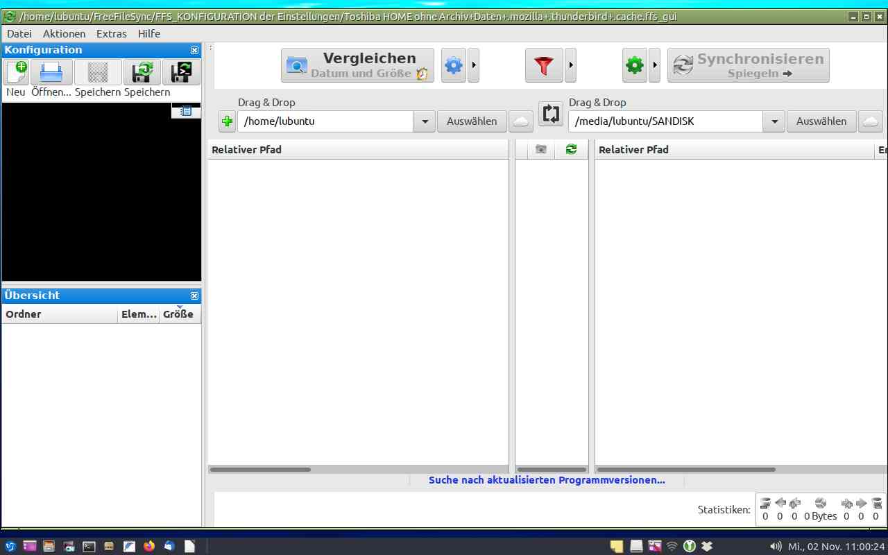

There is a serious problem when starting "FreeFileSync V11.26". Although "FreeFileSync V11.26" starts and I see the program window briefly, the computer crashes after a short moment.
If, on the other hand, I start RealTimeSync V11.26 from the same software, the computer does not crash, perhaps because the program window is not as complex in terms of graphics as with FreeFileSync, where the problem occurs.
When starting the "FreeFileSync V11.26" software and shortly before the computer crashes, the following message always appears in a small additional black window:

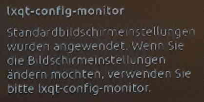

FreeFileSync Problem message when starting FreeFileSync under LUBUNTU 22.04.1

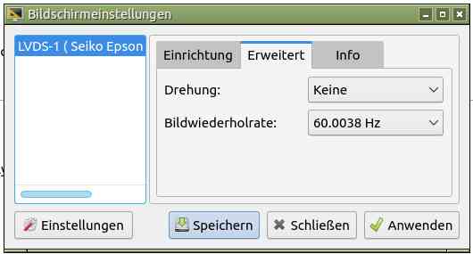

This message is displayed in a small black rectangular window, see my screenshot attached, when starting "FreeFileSync V11.26" briefly before the notebook crashes:
''lxqt-config-monitor
Default screen settings have been applied.
If you want to change monitor settings, please use lxqt-config-monitor.''

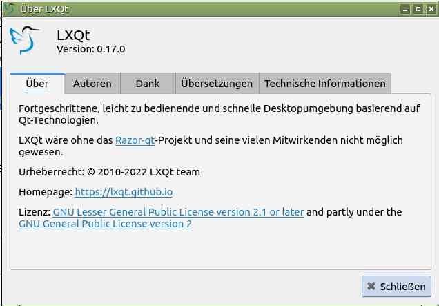

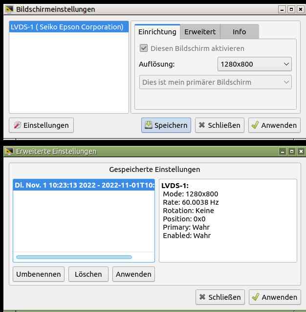

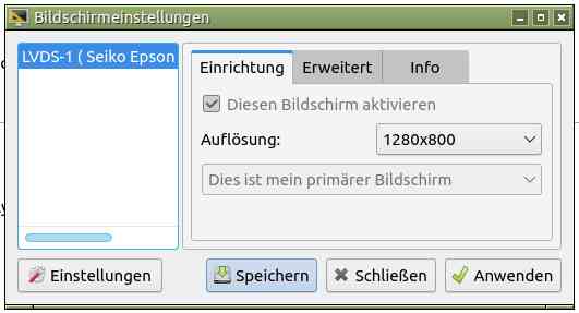

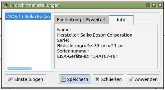

For information purposes, I am attaching 3 screen copies of the settings for the screen regarding lxqt-config-monitor:
Is there or can I add another screen for testing for the screen that is specified as "LVDS-1 (Seiko Epson Corporation)", e.g. on my netbook a simple "LVDS" without -1 and without manufacturer information , try it, which maybe works with a different resolution?
How would I have to proceed to add and configure an additional screen to the current "LVDS-1" for testing?
Now my question to you dear "FreeFileSync users", what can be the problem and how can I fix it, because I really want to be able to continue using this "FreeFileSync V11.26".
What can or should I do with this lxqt-config-monitor error, where in "LUBUNTU 22.04.1 Jammy Jellyfish".

- LXQT_INFO der Bildschirmeinstellung
- LXQT_INFO Bildschirmeinstellungen.jpg (17.39 KiB) Viewed 2934 times
- LXQT_Erweiterte Bildschirmeinstellung
- LXQT_Erweiterte Bildschirmeinstellungen.jpg (17.32 KiB) Viewed 2934 times
- LXQT_Einrichtung der Bildschirmeinstellung
- LXQT_Einrichtung Bildschirmeinstellungen.jpg (18.1 KiB) Viewed 2934 times
- LXQT-Config-Monitor Fehlermeldung in kleinem schwarzen Fenster
- LXQT-CONFIG-MONITOR_Bildschirm Fehlermeldung_20221013_231325.jpg (18.6 KiB) Viewed 2934 times

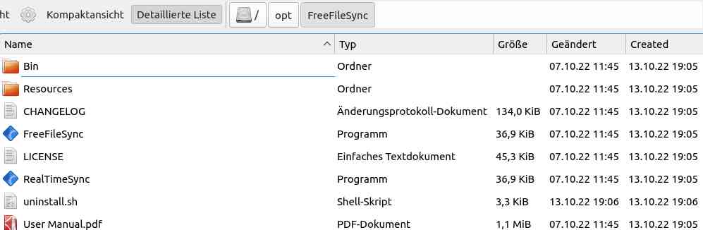

>Depending on How You Installed the Program, It Could Be in one of multiple places. /Opt/Freefilesync/would be a good place to look.<
This is correct, the program appears at: /opt /freefilesync
See also the screen copy in the appendix!

You could search your main program menu for "Terminal" or GNOME Terminal or KTerm or xterm or another terminal emulator program. People might call such a big, black window with text a "command prompt."
Inside such a terminal window, you can type commands to run. We want to cd (change directory) to the path that you showed us earlier in your file manager. The dollar sign here indicates the prompt, and you should type the commands that on the same line as the dollar sign. Do not type the dollar sign.
So this code block shows two separate commands. The first changes directory to /opt/FreeFileSync, and the second command tries to run FreeFileSync. The dot in this command means "current directory," so that you are saying to run the file "FreeFileSync" that exists in the current directory. Linux shells generally do not want to run commands from the current directory, so you have to tell it to use current directory with the dot-slash.
Unfortunately if running the program is going to completely crash your computer, then the program may not output anything to the terminal before we can look at it! I am not capable of providing support if it completely crashes your computer. That is beyond my skillset. Possibilites there include, the wrong architecture (but that should throw a different error and not crash), a localization problem (not likely), or something else.
$ cd /opt/FreeFileSync/
$ ./FreeFileSync

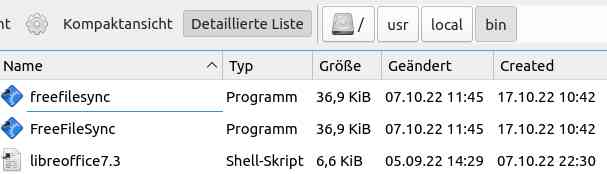

- Posts: 7535
The FreeFileSync installer places a symlink into /usr/local/bin (or /home/$userName/.local/bin"). Therefore it's sufficient to enter just:bgstack15, 16 Oct 2022, 21:06$ cd /opt/FreeFileSync/
$ ./FreeFileSync
$ FreeFileSync
Hello Zenju,
I've checked what I can find from the information you gave me.
Please take a look at my 2 screenshots:
I really hope that you Zenju as a "FreeFileSync" specialist can help me to regard my problem with "FreeFileSync".
The problem with the LUBUNTU 22.04.1 Jammy Jellyfish crash still persists, and I hope you will help me, because I am not a specialist like you.

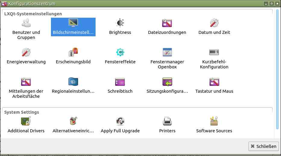

I have make 2 Screen Copies about what is in my LUBUNTU 22.04.1 Jammy Jellyfish to find.The FreeFileSync installer places a symlink into /usr/local/bin (or /home/$userName/.local/bin").
1. WY I have 2 Program Files_freefilesync + FreeFileSync_under_-user-local-bin-_2022-10-17
2. WY I have NO Files for_freefilesync or FreeFileSync_under_-home-lubuntu-.local-_2022-10-17
- Wy I have NO Files for_freefilesync or FreeFileSync_under_-home-lubuntu-.local-_2022-10-17.jpg (7.8 KiB) Viewed 2858 times
- Wy I have 2 Programm Files_freefilesync+ FreeFileSync_under_-user-local-bin-_2022-10-17.jpg (12.95 KiB) Viewed 2858 times

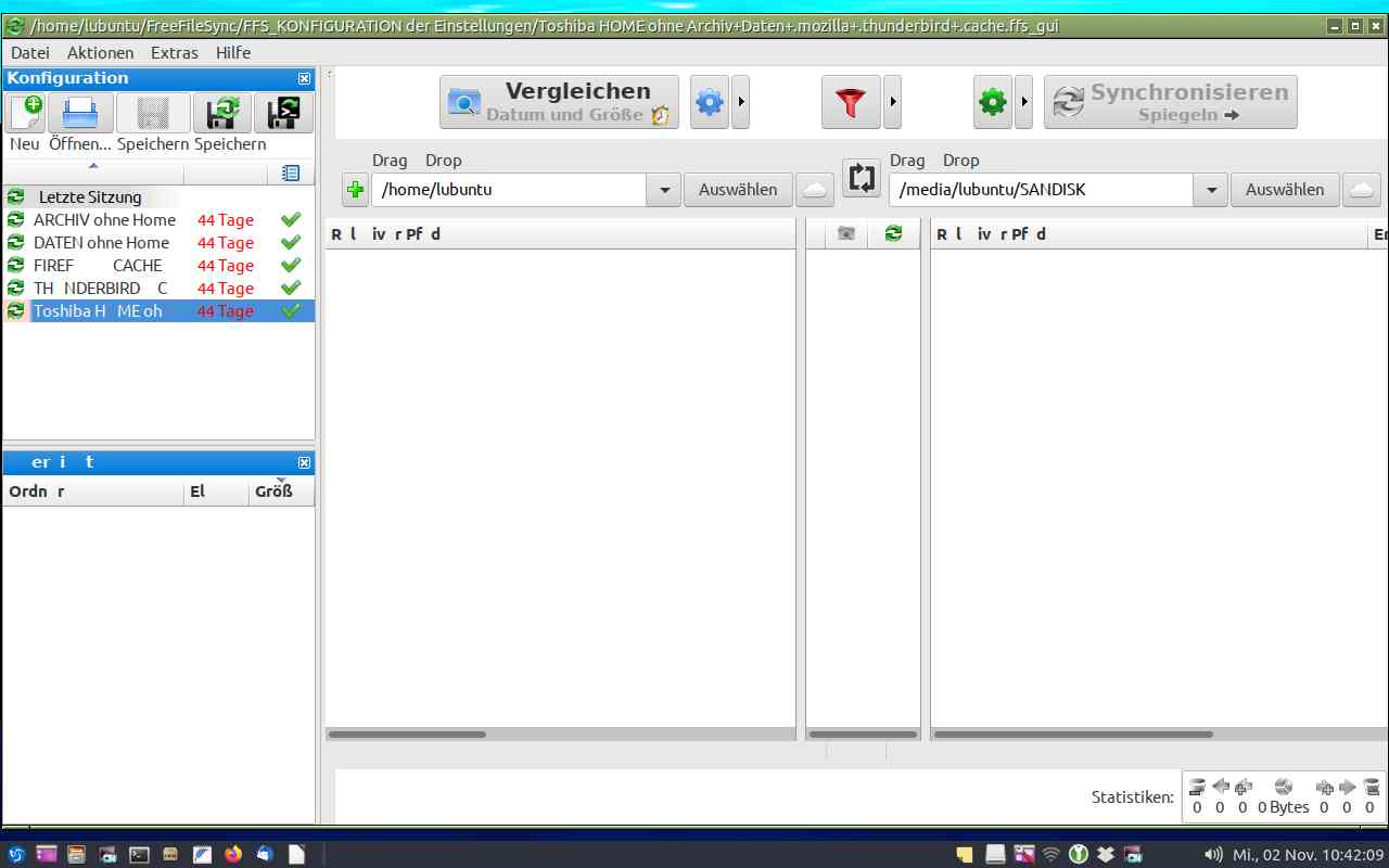

Hello, dear FreeFileSync USER team,
On October 14, 2022, at 7:24 p.m. I registered and logged in to the FreeFileSync forum here.
Since I had problems installing FreeFileSync 11.25 on my notebook, which was also newly installed with "LUBUNTU 22.04.1 - Jammy Jellyfish", I wanted to address my problem to you in the forum, hoping to get some help and support to solve the FreeFileSync issue I am currently having.
Today October 19, 2022, I installed the latest new version of "FreeFileSync 11.27" in the hope that this version might solve my problem.
Unfortunately this isn't the case, the same problem persists, just like with my previously tested other versions of "FreeFileSync" which were 11.24, 11.25, 11.26 and now 11.27, all of them have the same problem.
This message is displayed in a small black rectangular window, see my screenshot attached, when starting "FreeFileSync" briefly before the notebook crashes:
What shall I do with this error message?
Maybe the settings off the monitor, is the reason for the Problem, but how to change this?
Is there anything I can do about this somewhere?
I would be very happy if one of you could give me helpful tips because I need this "FreeFileSync" very much to synchronize my second computer, a netbook.
Remarque: I have today also updated "FreeFileSync" on my Netbook with the version 11.27 and it is working there without problem, the only difference is that my Netbook works with LUBUNTU 20.04.5, means the last version before the upgrade to 22.04.1.
PLEASE ! PLEASE ! HELP ME !
"lxqt-config-monitor"

For - run: lsb_release -a:
For - run: lxqt-config-monitor:
Attached you will also find a screen copy of the lxqt-config-monitor: MONITOR SETTINGS screencopy-_2022-11-01.jpg
For - publish the version of QT you use
My question is: What does "version of QT" mean, where can I find this information in LUBUNTU 22.04.1, or how can I call up this information with the terminal and then send it to you?
If your question here concerns the LXQT Version: 0.17.0 system settings, then see my screen copy in the attachment: LXQT Version 0.17.0 INFO screencopy-_2022-11-01.jpg
For - publish the contents of the launcher (.desktop) or shortcut icon for launching LXQt-config-monitor
To open or run the LXQT_Configuration Center I can do this via: /home/lubuntu/Desktop/lxqt-config.desktop
The screen that opens is the following, see ScreenCopy attached: LXQT_CONFIGURATION CENTER screencopy-_2022-11-01.jpg
lubuntu@toshiba-satellite:~$ lsb_release -a
No LSB modules are available.
Distributor ID: Ubuntu
Description: Ubuntu 22.04.1 LTS
Release: 22.04
Code name: jammy
lubuntu@toshiba-satellite:~$ lxqt-config-monitor
Icon theme "breeze" not found.
Connecting to

- LXQT_KONFIGURATIONSZENTRUM screencopy-_2022-11-01.jpg (35.89 KiB) Viewed 2732 times
- LXQT Version 0.17.0 INFO screencopy-_2022-11-01.jpg (24.36 KiB) Viewed 2732 times
- MONITOR SETTINGS screencopy-_2022-11-01.jpg (36.19 KiB) Viewed 2732 times

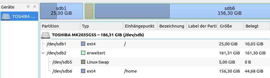

PS:Please clarify the type of partition you use (ext4, Btrfs, ntfs, fat32, etc) where is the operating system, FFS installed and where is the folder you intend to sync

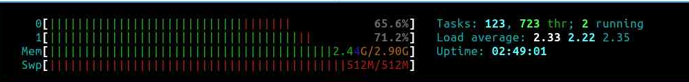

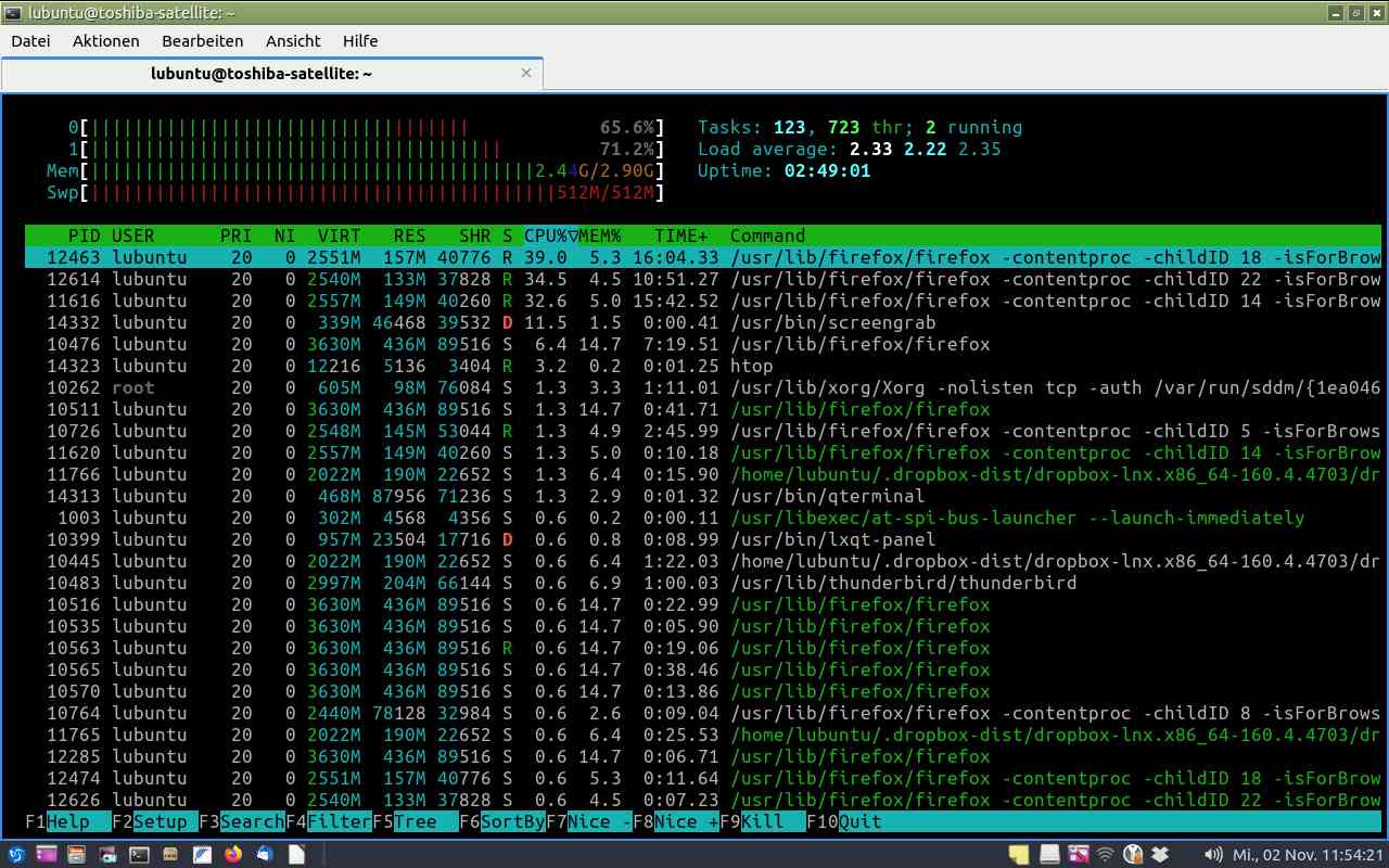

For - Run "htop" in the terminal:
That doesn't work because the notebook crashes.
As INFO, I am sending you a later screenshot of -htop-:
When starting FFS, I sent you 3 screenshots in the attachment for INFO:
2.- 20221102_11h42m01s_First FreeFileSync screen displayed after Start_screencopy.jpg
3.- 20221102-11h42m05s_Second displayed FreeFileSync screen after start + before crash of PC_screencopy.jpg

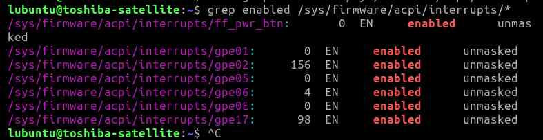

For the grep enabled /sys/firmware/acpi/interrupts/*
See the attachment: 20221102_12h56m05s_For the -grep enabled-sys-firmware-acpi-interrupts*-_screencopy.jpg

- 20221102-11h42m05s_Zweiter angezeigter FreeFileSync Bildschirm nach Start + vor Absturz des PC_screencopy.jpg (58.17 KiB) Viewed 2670 times
- 20221102_11h42m01s_Erster angezeigter FreeFileSync-Bildschirm nach Start_screencopy.jpg (61.14 KiB) Viewed 2670 times

There you have your answer to the problem. HTOP is showing it to you:
Your PC is at the limit of its capacity. The laptop does not have enough RAM memory to run any programs and is filling up the swap. Reviewing theToshiba Satellite L300-25E datasheet, these are its features:
https://es.dynabook.com/discontinued-products/satellite-l300-25e/
Processor: Intel Pentium T4200
Hard drive: 250GB
RAM: 2GB DDR2 (800MHz)
Video: Intel GMA 4500M
These features are not supported by Ubuntu 22.04/20.04 LTS
Recommended Minimum System Requirements ubuntu 22.04 (These requirements also apply for ubuntu 20.04)
https://help.ubuntu.com/community/Installation/SystemRequirements
Ubuntu Desktop Edition
2 GHz dual core processor
4 GiB RAM (system memory)
25 GB (8.6 GB for minimal) of hard-drive space (or USB stick, memory card or external drive but see LiveCD for an alternative approach)
VGA capable of 1024x768 screen resolution
PS: 4GB of RAM means only for the operating system. To run programs you will need to increase the ram memory (8GB minimum recommended)

FFS I'd think to be a relative lightweight - memory-wise.
So, if you were to Quit Firefox first (& might as well quit Thunderbird too), would FFS then open & run without issue?
(And I suppose that after quitting FF, it can't hurt to run another HTOP & verify that Swp usage has declined, significantly.)
It appears that Firefox is using the most RAM.The laptop does not have enough RAM memory to run any programs and is filling up the swap.
- Posts: 42
- Joined: 29 Jan 2018
@therube My opinion does not change. This is not a problem with FFS but with the laptop, which does not have enough resources and does not meet the minimum requirements of the operating system it has installed. So no matter what you do to reduce system load, it won't be enough.
I'm amazed how this laptop, with 2GB of RAM (DDR2 800 Mhz), boots up and gets to the desktop without crashing
The English text was translated from German to English using Google translator!@therube My opinion does not change. This is not a problem with FFS but with the laptop, which does not have enough resources and does not meet the minimum requirements of the operating system it has installed. So no matter what you do to reduce system load, it won't be enough.
I'm amazed how this laptop, with 2GB of RAM (DDR2 800 Mhz), boots up and gets to the desktop without crashing acg, 02 Nov 2022, 15:24

ATTENTION! I don't have 2 GB of RAM, but 3 GB of RAM installed on the notebook.
For testing purposes, I deactivated all unnecessary programs on the notebook before I started FFS again for testing.
In addition, I have no other problems with my TOSHIBA notebook than only with FFS.
Surfing the Internet with FIREFOX is easy and even fast.
I can even watch TV programs and video films without any problems, without jerking and without dropouts.
The THUNDERBIRD email software also works quickly and easily.
I also work a lot with LibreOffice, WRITER text and also CALC tables every day, this LibreOffice software also works perfectly and also quickly and without problems.
So I can't understand why you think it's a notebook problem and not caused by FFS.
In order to show you the notebook conditions under which I started the FFS again, but had to experience another crash, I am sending you screenshots in the attachment with the information on the memory states before the start of FFS or the freezing of FFS and subsequent crash of the notebook.
Appendix:
1.- 2022-11-02-19-26-25_Used Memory before START FFS_All NOT necessary programs are stopped by mee_screencopy_.jpg
Greetings HELMUT
- 2022-11-02-19-26-25_Used Memory before START FFS_All NOT necessairy Programms are stopped by mee_screencopy_.jpg (8.98 KiB) Viewed 2611 times
- 2022-11-02-19-32-11_PARTITION INFO from NOTEBOOK_screencopy.jpg (21.31 KiB) Viewed 2611 times
- Posts: 1239
OK, so your Swp is well down, & you are still having issues, so that probably (well, IMO) points to Swp not being the issue.
So then (& I know nothing of Linux), I would look at the "lxqt-config-monitor" end of things (of which I'd have no clue).
Does Linux have a "safe mode" of booting or are you able to use a different "windows manager" (no idea what I'm saying here ;-)) kind of thing?
(And then there was also that part where your earlier OS version did not have this issue...)

LXDE was the standard desktop environment in Lubuntu, an Ubuntu derivative which received official endorsement in 2011, up to and including Lubuntu 18.04 LTS (Lubuntu switched to LXQt starting Lubuntu 18.10).
the problem is that ltqr is no longer oriented to PCs with few resources, like yours, but to modern PCs, which makes it not feasible to use lubuntu 22.04 and for this reason I have suggested several times that you downgrade, up to 18.04, which was the last version LXDE used
About syslog:
According to the information provided in the pdf file, your PC have a problem with its graphics card and sddm. Perhaps this new version of lubuntu has made changes to the video driver or to sddm. I'm not 100% sure
Possible solutions:
- run:
and if there are errors try this solution
https://superuser.com/a/1721403/886205
- You can also try disabling the video driver or booting in recover mode and try FFS in this mode
https://linuxhint.com/boot-ubuntu-into-recovery-mode/
- Or you can also boot your laptop with Ubuntu 18.04 LiveCD and try FFS in this mode
My recommendation is the same.
Sorry I can not help you anymore

To close this issue, FFS works normally on Lubuntu 22.04. Maybe this will be useful to another user who uses this distro.
